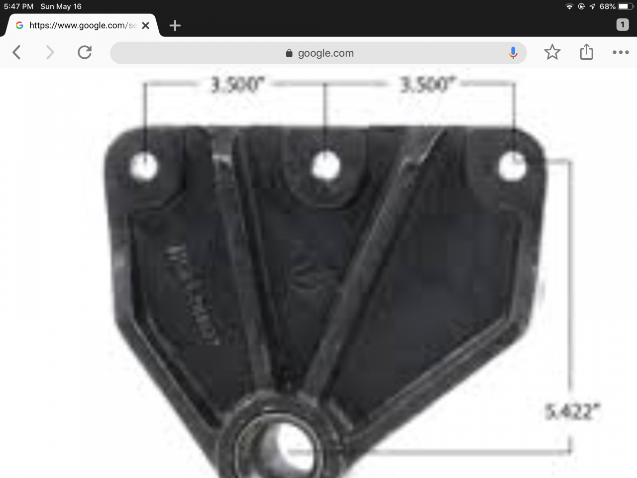

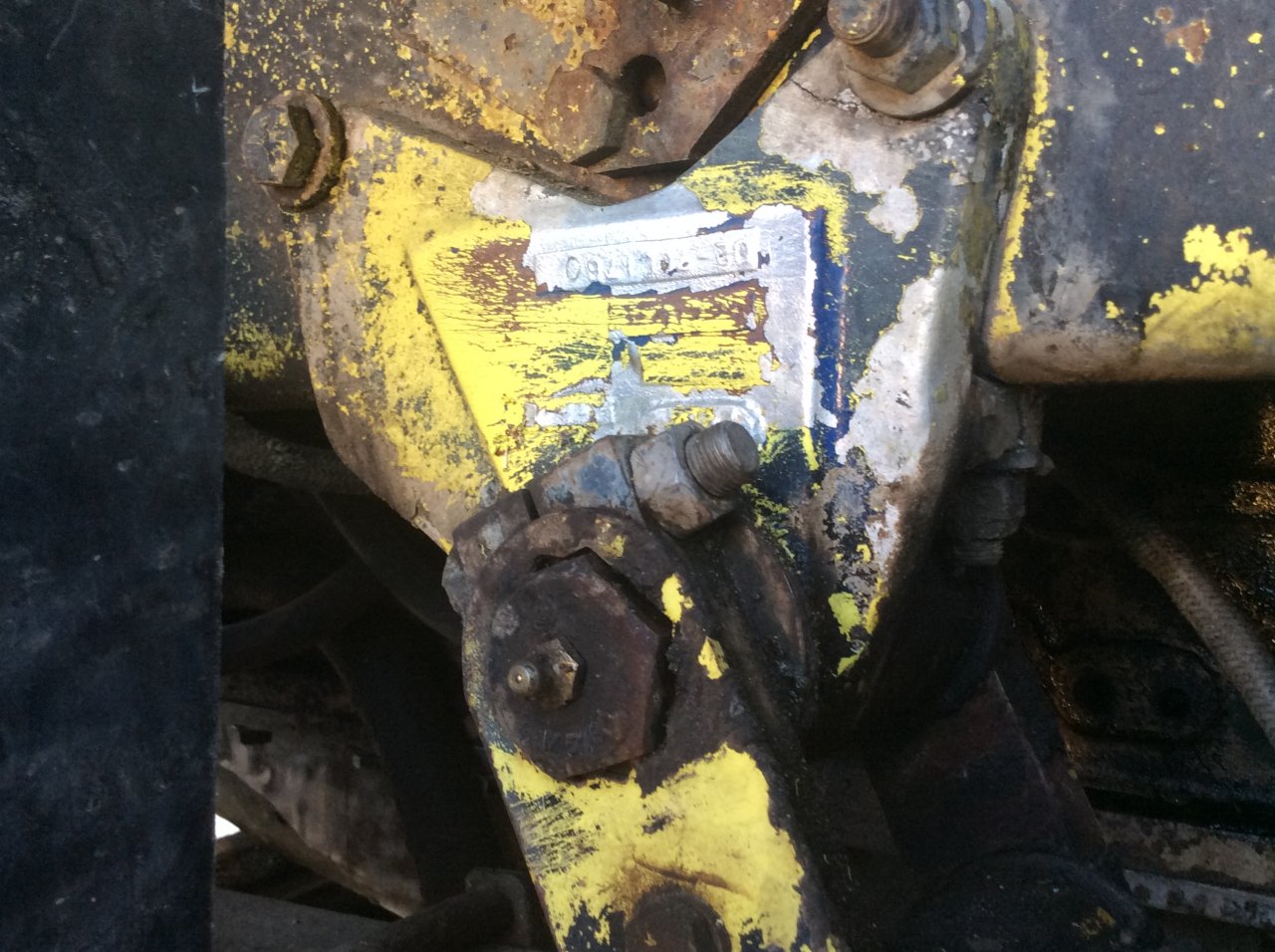

    New to this forum and looking if anyone has gone through a replacement or upgrade to the front rear spring hangers as the originals aluminum are both cracked.
    I have found two from a 2002 which are steel and clearly stronger but holes are different as well as the spring pin distance will be 1” lower from the bottom of the frame. Easy enough to have new bronze bushings made to accept the original 11/8 spring pins but just check in case someone has already done it.

    All the old W-WS’s I’ve been around had the aluminum rear hangers replaced with cast iron ones from the White 4000’s.
    The front ones were aluminum too. Since they were also the bumper brackets and tilt hood hinge mounts all in one they always were cracked quickly. They were cast iron on most of the Whites but they too also used some aluminum ones here and there. All the hangers are gonna be a salvage or nos part only. Pins and bushings should still be availiable from a good spring shop.
    We’ve built some of our own over the years out of pieces of frame plate and thick wall round tubing.

    Thanks I think we are on the right path with the newer Western Star part.
    Luckily the fronts were fine perhaps because this doesn’t have the tilt front end just tilting fenders and they are supported off the frame

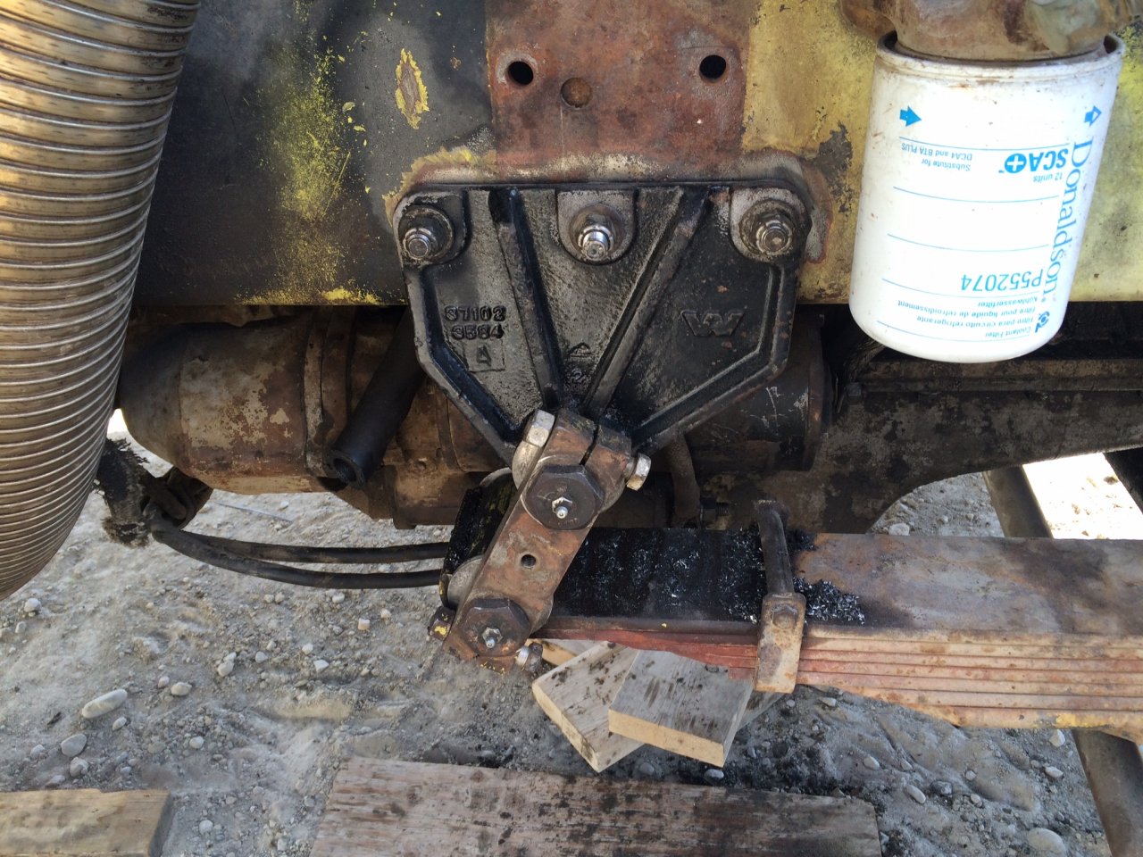

    2540D19F-A89D-44DD-ACDA-26EAF2745B45.jpeg 511E579D-83ED-403D-B56D-1C60B6F56505.jpeg
    Pretty much finished with the replacement front (rear) spring hangers
    Had to have the bushings made up so we could still use the same shackles and pins so we didn’t have to change and make the spring bushings.
    And I guess we lucked out on the Fronts as they were already made of steel.
    A few more things to do and then the old girl is roadworthy again!
