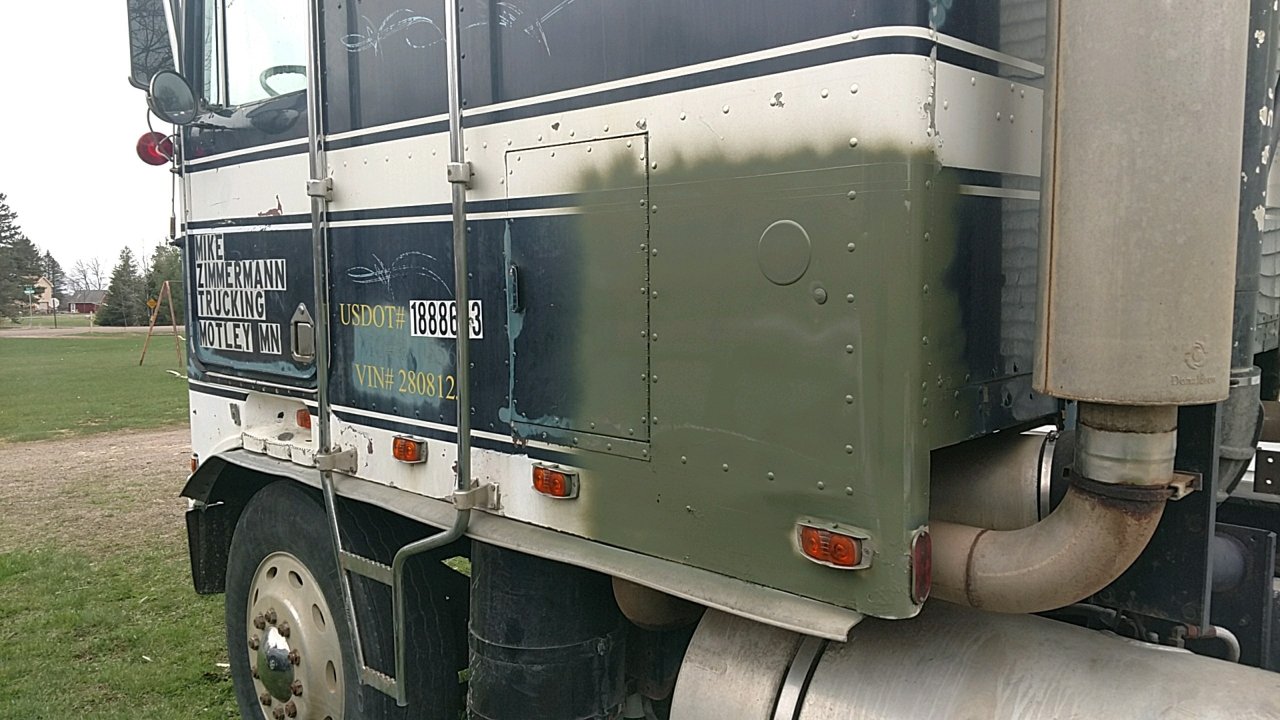

    That's the Color she's going be just did little area to test quick. Crome will be blacked out.
