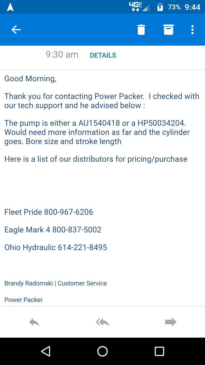

    That's the pump part numbers from power packer if anyone would ever need it.
