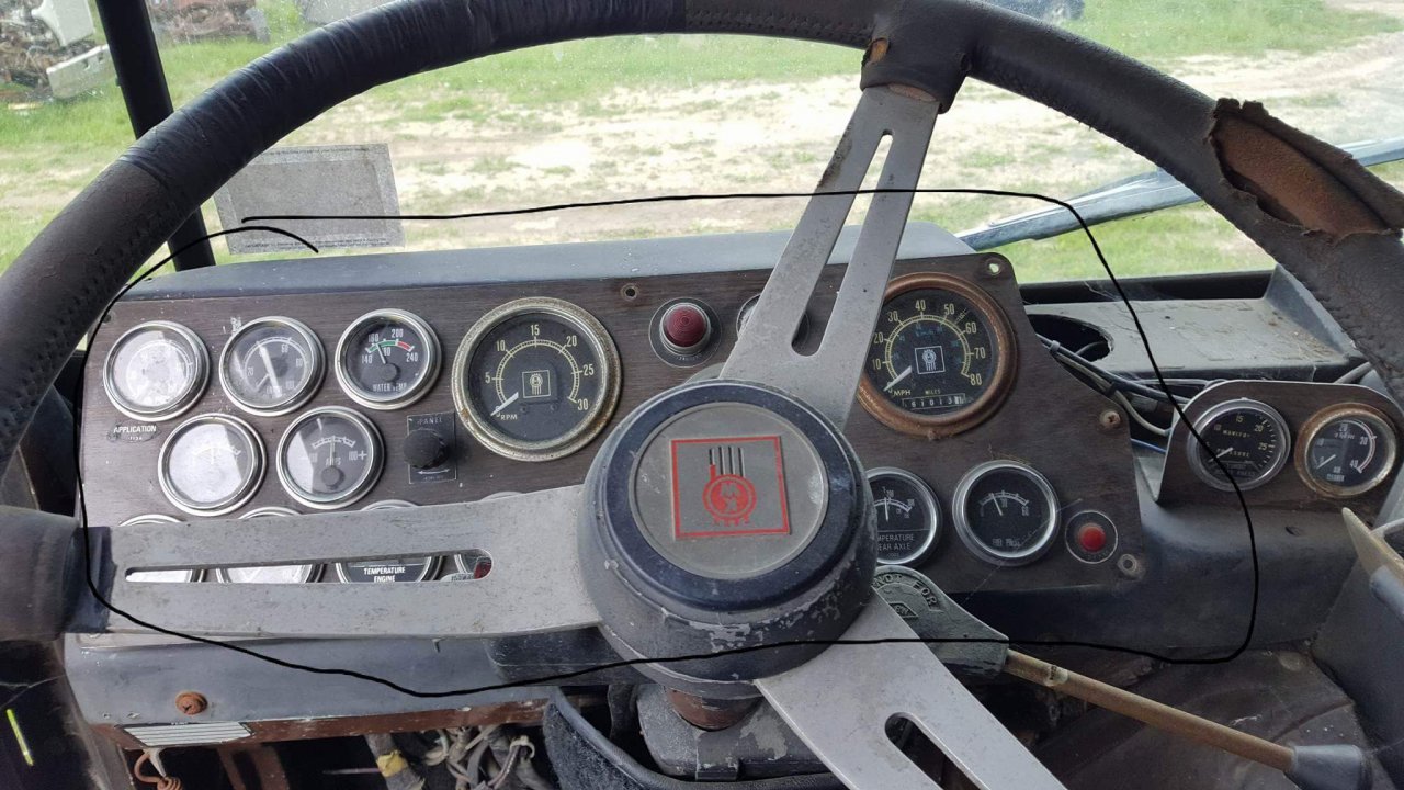

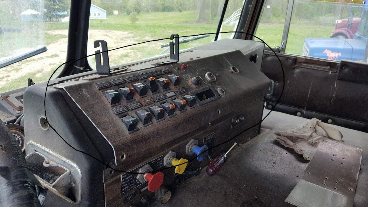

    Bought some spare parts, both dashes and the aux guage too. Have some more random parts I just bought lil hard to find. Been raining cats and dogs haven't been able to get any work done on her. IMG_20170513_163954280_HDR.jpg
    DDlighttruck Thanks this.
