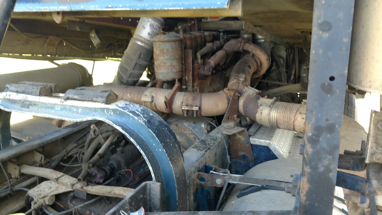

    Why don't you just find a hydraulic shop and have them rebuilt your own rams/cylinders ? That's what I did . Specially the passenger side, it gets more heat from the exhaust and causes the seals to fail.

    Fleet pride said it wasn't a seal that it was a check valve and they couldn't fix it. They recommended getting a new one. Talked to my shop mechanic they recommended that I should just get new ones to be safe since everything been sitting for almost 9+ years... The cylinders will be here next week. Power packer has to make them new. Anything else happens I will get them rebuilt

    Sheeeet. If you can get new cylinders for $232 each thats cheap..
    If your old ones need re chrome and seals probley cost lot more getting them rebuilt.
    Your doing the right thing.
