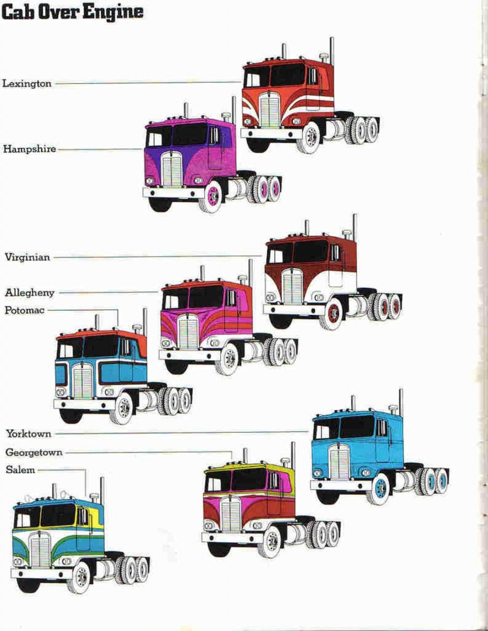

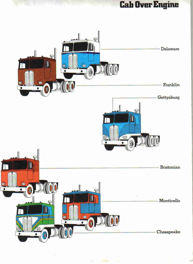

    KWK100stripepatterns-vi.jpg k100patterns2.jpg @Adisiwaya
    Heres the factory K100 paint schemes, keep in mind that these are just rough estimates cause ya could get em in any paint combo ya wanted, like the Salem scheme, ya could get just Red/White or Red/White with Black/Gold or Black/Gold/Black breakup stripes or other colors... Maybe this will give ya some ideas for yer KW... I used ta have pics of the dealer sketch forms that dictated what colors went where when some lucky so n so ordered his new cabover... Lost em with my dang phone reset...

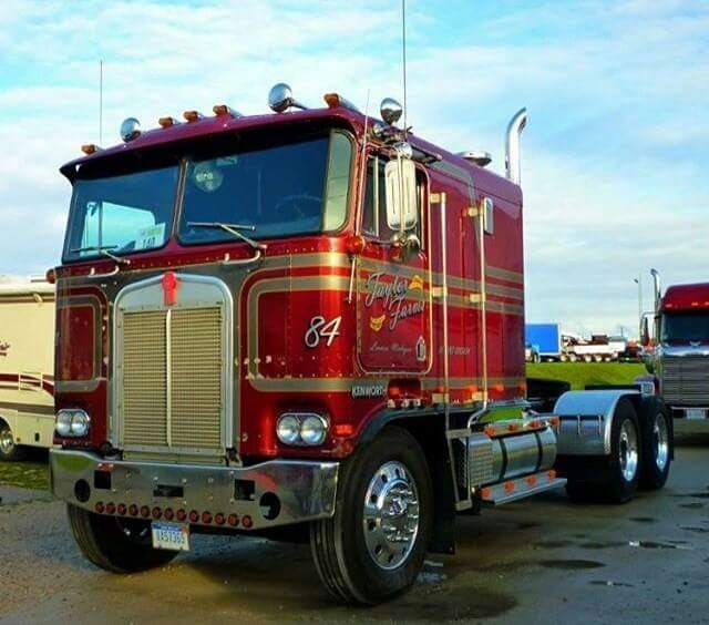

    Im really diggin this color combo! Man would that just be the cats youknowwhat if it was a Salem deal...
