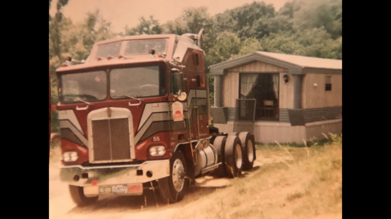

1980 K100 Cabover Project/daily runner

    I have a recommendation: where the tracking arm bolts to the frame ( passenger side front differential) cut a diamond shaped piece of 1/2" steel plate. Mount it on the outside of the frame. Put two more bolts , on each side of the diamond shaped steel plate. This will prevent the tracking arm from literally breaking through the frame. I have had to make this modification to steel frame KW's as well.

  4. Adisiwaya
    Adisiwaya Light Load Member
    252
    326
    Mar 25, 2017
    OLDSKOOLERnWV how hard is it to replace the airbags? These don't leak but have more dry rot than I want to deal with if they break on the rode. I figure it's better to change them now while I'm not running loads Vs when i am. Going try to get all the preventative maintenance done of everything that might go.
