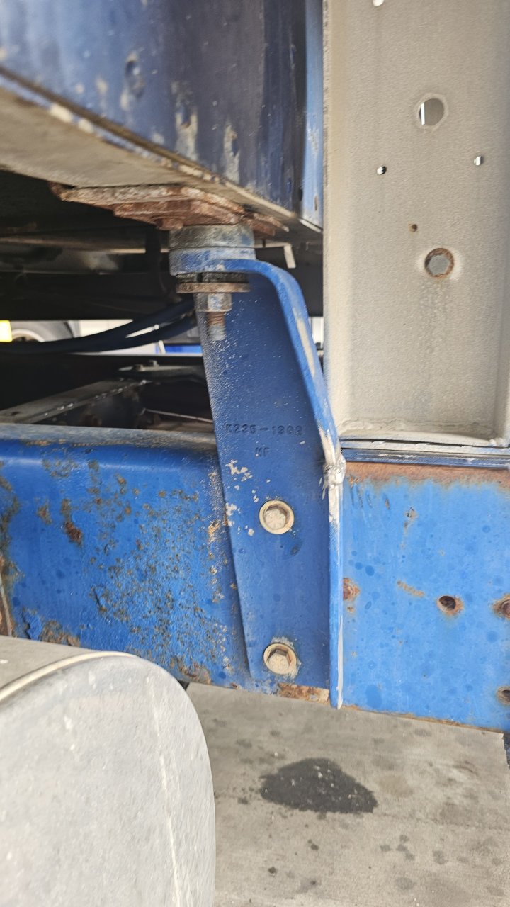

    That's exactly what caused this to. It was blocked and it's something I never thought about till it happened. I'll be cleaning the front one tomorrow. I have to figure out and fab sleeper mounts tomorrow. Cant seem to find any one from junk yard so some steel ones will be made Snapchat-971188130.jpg

    I’m not a hundred percent by any means. But that looks a little like the rear motor mounts on a mid nineties Pete with a CAT.
    the rubber part I mean. Probably just enough size difference to make you cuss cause they won’t work
