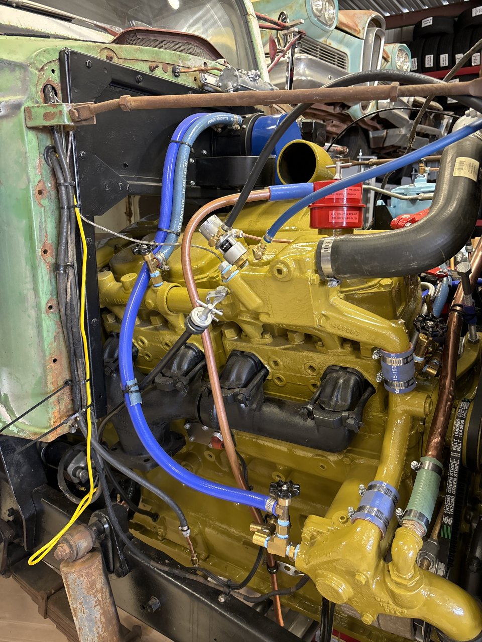

    Looking at those pics closer, I would come straight out of the rear hsg with 90* elbows then the valves. I would use both ports in that hsg too, instead of running both returns to one.
    I would run the hoses along the top of the frame rail with frame clips and insulated clamps.
    And my opinion only, tank heaters are unnecessary, and offers too many more failure points, especially on a 40 yo truck.
    They are usually the first thing I get rid of.

    Ill re route the coolant lines when I'm home next week. Keep them closer. I'm not getting rid of my tank heater. I need them. -40 degree temps without the windchill ain't any time to be messing round with gelling up diesel. I did run the ole girl for 2 years before she rejected a piston.

    Ditch the ball valve for the tank heater. You should use the gate valves that normally come on those engines. That way you can regulate the coolant flow to the fuel tank in case its getting too warm. Also, Fass fuel system has a heater that you can add onto their pump, so you have heated fuel on a cold start. You can get away with #2 diesel if you do this, within reason of course. The cost difference between #1 and #2 would pay for the heater, if you can find #2 in the north during winter.
    Also, your half inch pipe manifold is orientated so that it will loosen with vibrations. You could just use one 3/4 in gate valve that has a heater hose barbed end, and then tee off of the hose if you need to.
