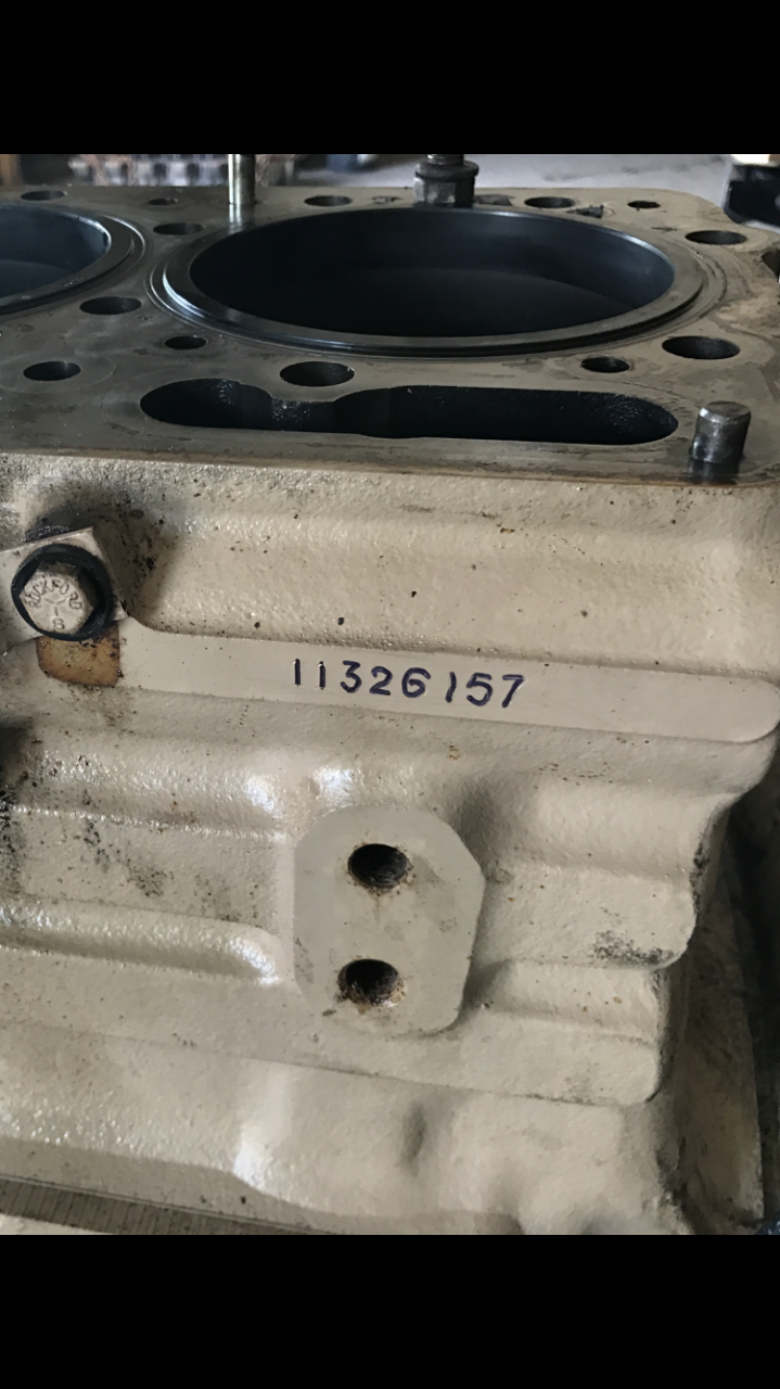

    Look on the block just below the rear head gasket on drivers side, the serial # will be in the block at the rear corner. Give Cummins that number and they will tell you what it started it’s life as. Give you the original CPL # too.
    My engine started out as a 315 hp, but I have all 400hp+ stuff in it. 365, 400 and bigger uses a different piston than the smaller hp engines. That pump could just be something he put on to get it running, or it could be legitimate and engine is only 310.

    This is what you are looking for on the left rear corner of the block.
