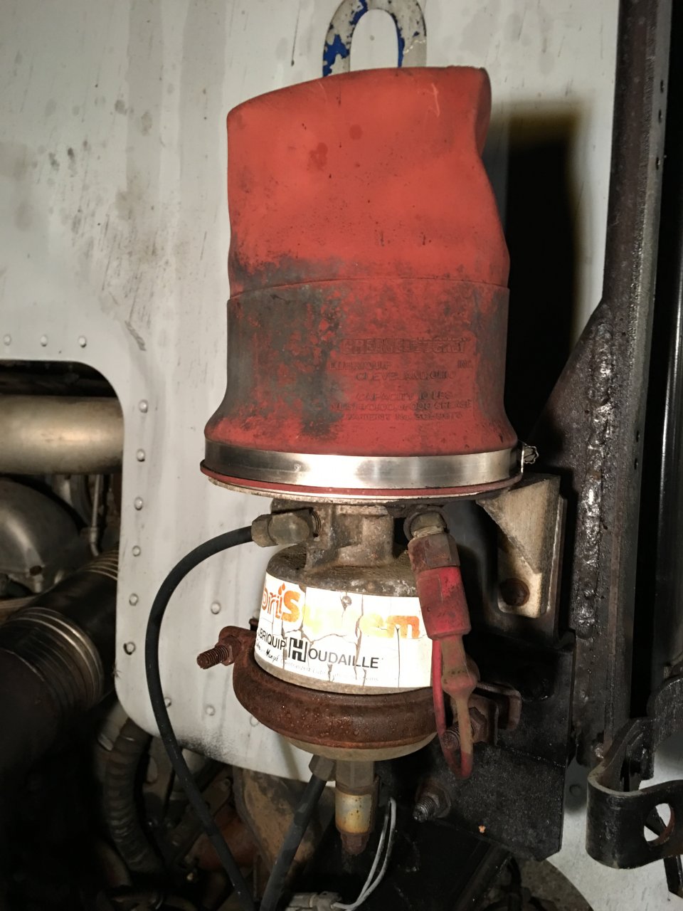

    IMG_2134.JPG IMG_2135.JPG IMG_2139.JPG Another mystery to me...obviously banged up on top...some kind of Lube device...

    It is listed on the build sheet. The one's I am familiar were labeled as a grease jockey and I got parts from Mid West Wheel in Des Moines. The red boot to the right is on a quick coupler that we connected to a 5 gl bucket of thin grease-thick gear oil and refilled the bag on top. It should have an adjustable timer somewhere so that it cycles about every 15 minutes when the parking brakes are released. It will lubricate everything except the drive line and steering joints. They did a really good job and required little maintenance just a little messy. With the age of yours you maybe better off to trash it and put grease fitting in everything.

    That container on the back is an auto greaser, like Box Car sez, Schneider had those on their 4070 Transtars. Logic was, the trucks were gone for so long, it greased everything but the driveline, including the cars behind them. That would NEVER fly today, as leaking fluids is a Cardinal sin today.
