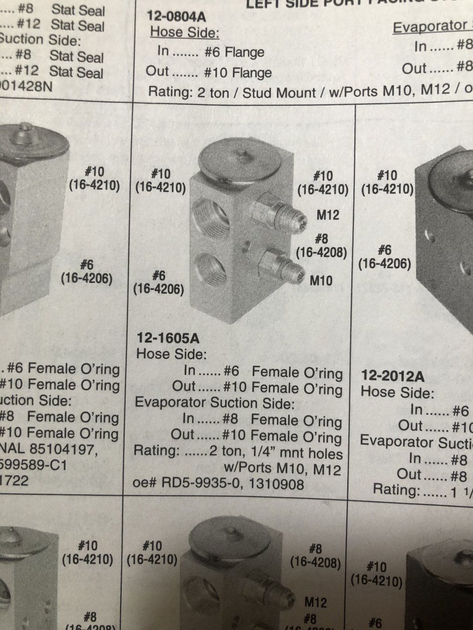

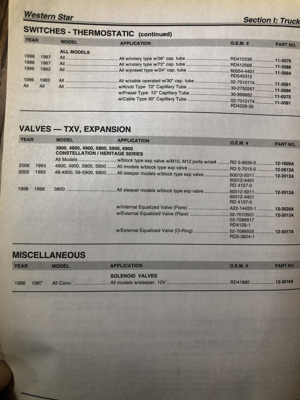

    C53A08D1-33AE-48CB-85AB-034C7E412FC4.jpeg Expansion valve, here’s what the book says. I notice yours says 134A. Can’t find that # though.
    n4ane Thanks this.

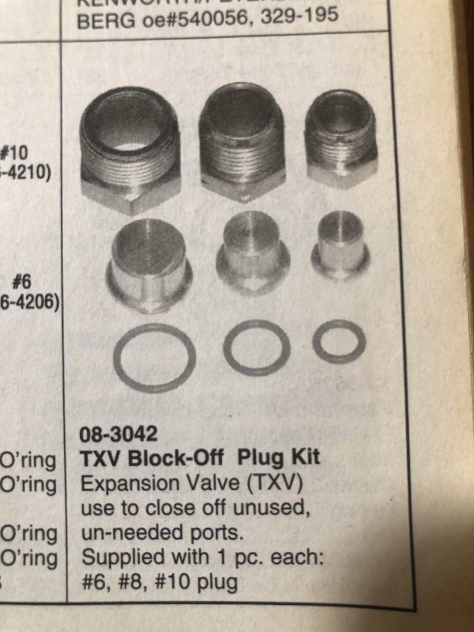

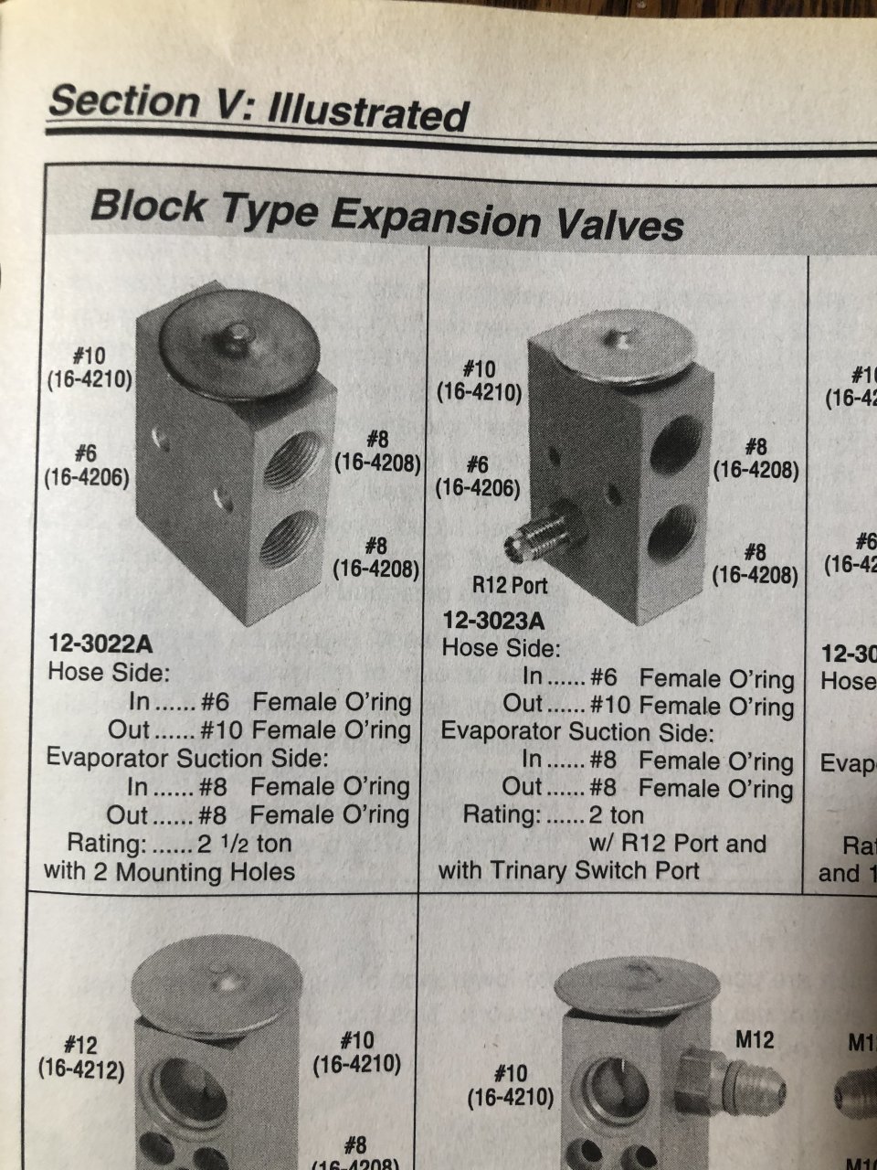

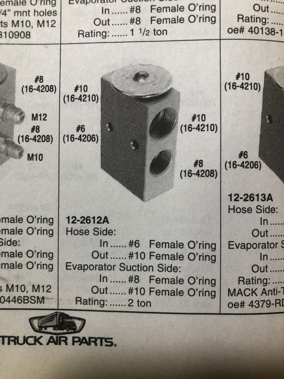

    48EBA878-6B19-4602-AADD-85EC5BDBF71A.jpeg 2D649C0C-7627-46AB-9566-7ECECA737661.jpeg 1F8ED075-631C-459E-AD38-82F9DE152FBB.jpeg Here’s the ones showing in the book. Last 3 on list aren’t shown at all.
    n4ane Thanks this.

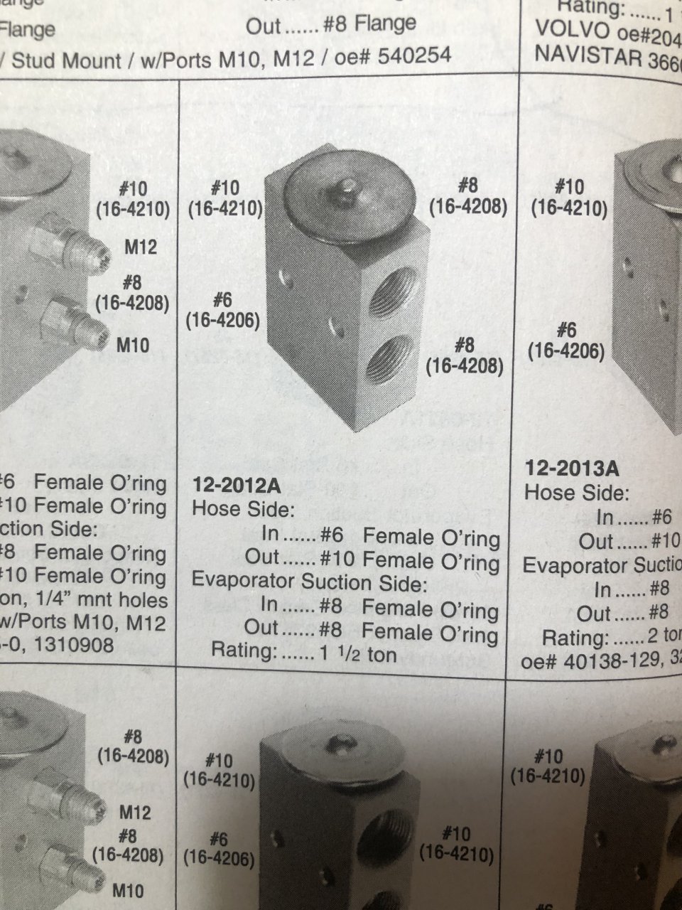

    826CD8D5-AF56-48EE-8C5A-4428DE6CBEAC.jpeg 77561B88-9327-4F60-9BFF-69722041FEB3.jpeg Apparently someone has upgraded the valve. No telling. Here’s an example of an r12 and a 143a ones 2 ton, others a 2.5 ton. Tonnage rating, along with type of thread/ fittings seems to be the key to finding the correct valve in your case. They also have plugs available if needed, to make a 4 hole work as a 3 hole. You really should just change out that compressor, along with new ported 134A lines, if you don’t already have them. New compressor doesn’t have ports, like the R12 compressor does. I can look up correct compressor based on plug, pulleys, and hose fittings. New hoses will need to fit new compressor. Depending on what combinations are available, there’s different options sometimes. It would be best to get a common compressor, that’s readily available, due to cost differences. Oddball compressors are a lot more $$ and hard to get. Nows the time to pick a compressor and get proper lines/fittings for it, and expansion valve, and condenser.
    n4ane Thanks this.
