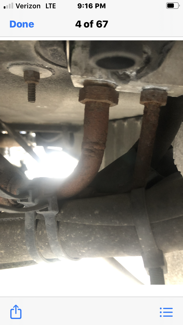

    I may get new lines currently I just come back from a front diff the left the chat in a bad way. had to replaced everything but the housing and couldn't find any used parts near by so everything is new. Also every thing has to wait at least 2 weeks if I replaced the evap and condenser 1800 radiator will have everything else tomorrow. currently someone has replaced the lines somewhat newish and they are routed fine the only change I would make would be put the line straight into the expansion valve where there is currently a t fitting since it used to have a bunk.

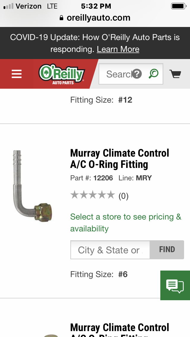

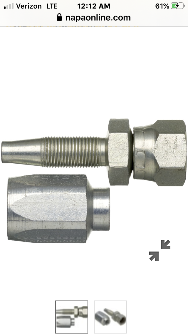

  11. Rideandrepair
    17,580
    56,946
    Aug 8, 2015
    4042C571-F551-49C1-AD9B-77F59953E6C7.png I googled reusable hydraulic fittings. There’s a bunch of different ones. Here’s a picture of one apart. To give an idea how they work. You would still need a male fitting of some sort to weld onto the fittings being used. For the swivel to thread onto.
