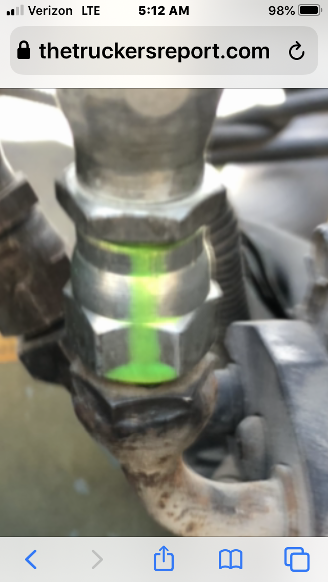

    The fitting I used only need a piece of hose to work. The original fittings are welded to a fitting that screws into the reusable fitting. Look close at the picture I posted where it’s leaking. You can Definitely buy and a crimp tool to make your own hoses. Vintage air is a great Source. They even sell and suggest buying Chinese Knockoff Sanden Compressors, they claim perform just as good as US made. I wouldn’t buy one myself. I’m only cheap to a certain point, not worth the 20% savings. As far as skipping the bunk air. I’ve went without heat, for a couple years. No problem, Cab compensates. But A/C is a different story. Got to have it in a bunk. Mine at least. Most bunks already have the set up. And if for some reason there’s a problem with one, like a hose or expansion valve, you at least have the other. Ofcourse if the compressor or condenser goes bad, both are down. The factory lines to compressor are expensive, making your own saves hundreds. Along with the fact that using 2 couplings and a threaded coupler, you can repair a hose that’s been rubbed somewhere and blown at a weak point. Much like a repair coupler for an air line. Rare, but it happens.

    6C2B25AE-C5DD-4458-B92D-7A654352FBB0.png Here’s the pic again. Look below the green dye. Original pad mount A/C lines from an old line set are welded to a threaded female fitting, that you screw the swivel end of the reusable fitting onto. It’s welded a bit too much, barely can get a wrench on it, because its been welded on a different fitting, once already, when I had a different compressor. I had to put a pipe wrench on it to stop the leak. The right way to weld it is like the other one in the pic, plenty of room for a wrench. I had to cut the damaged hose end off, along with the old fitting, and put a new one on because the hose was damaged at the end, it got kinked and had a weak spot, from moving the compressor during an inframe. Reusable fitting has a swivel end. It can be taken off, put onto new hose. And installed. Bulk hose line is all that’s needed. best to have an extra fitting on hand, as old hose really gets stuck in the fittings. Some heat, and a small screwdriver may be needed, to get the old hose out, making the fitting reusable again. I was struggling with that, so I got a new reusable fitting from the T/A, they had one. Now I have a spare, if needed for a quick repair. Beats spending $$$ and hours in a shop.
