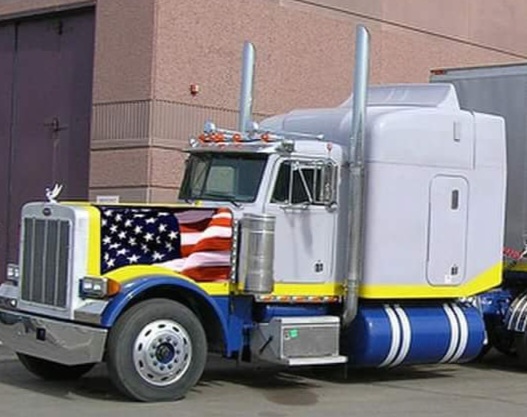

    I would have attached them but didn't have any good ones showing the hood. Here's the best I have now. I'll post more on Monday when I'm back with truck.

    I put my level on my hood and it shows about a 3° angle. So it's really not noticeable.
    Maybe your hood is from a different year 379?
