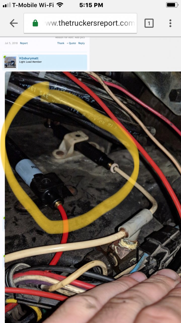

    E28ECD94-004D-4216-8518-DD4C9B05F2FE.jpeg What are the part numbers for these 2 actuators or cylinders looking deals ? I have a 94 (379) and both of mine are leaking.

    They're iny first post in this thread. They start with DA, dual actuator is da 10000 and single action is da 10050.
    Those are the Pete numbers and you can find them via other sources for less money. The first dual action one I got was faulty and I had to start a warranty claim and am waiting for them to approve my refund.
