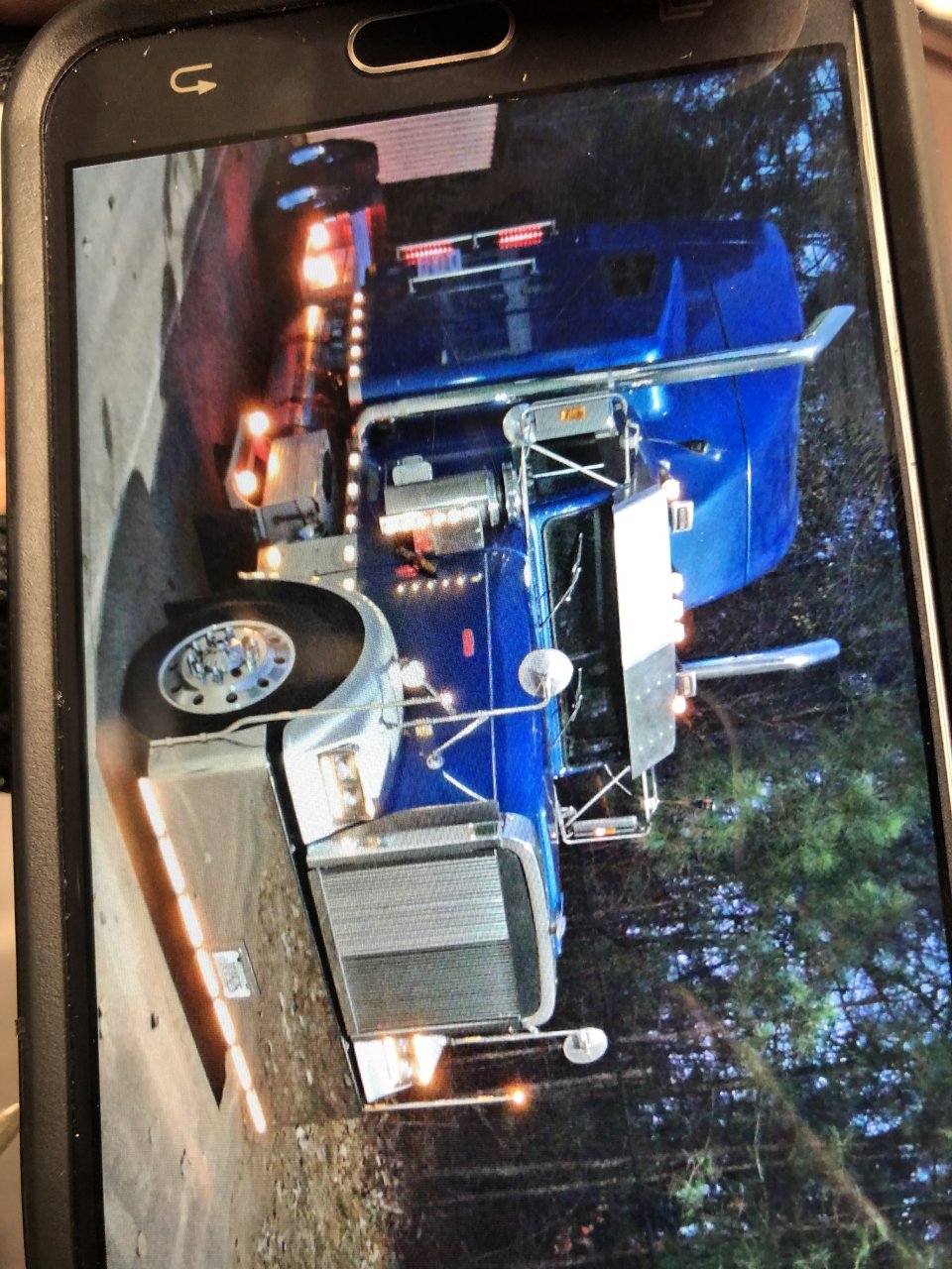

    Thanks you guys for the feedback... it’s super helpful!!! Here is a picture of the truck he sent me I’m just getting home so I haven’t had a chance to stop and see it in person!! Thanks again!!!

    He sent me this picture I’m just getting home so I will take my own pictures today and post them for y’all but this the one he sent me!!

    That’s a nice looking Truck. It must have a 425 C model Cat. The C was a good engine. Had larger rods and mains.Recommended to change @ 500 k instead of 250 k on b model. Otherwise same as a b model.Great engine. Was the king of the hill for years. They were available
