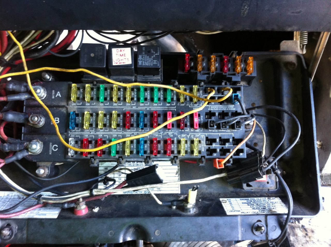

    I know you are deep in your problem. . . .may i suggest you a very simple test. . . . .
    In the cab in your fuse box you three row of fuses A-B-C
    A at top B in the middle and C at the bottom
    If you can use a head lamp bulb as test light (it pull more amps) (not a std test light) check at the fuse position B-6 with the ignition key at ON position check if your big test light comes ON and bright, next check at the Fuse position B-8 if you turn ON your big test light
    (note B-8 is one output of the ECM power relay)
    Let me know your result please.
    Ben
    aron12 Thanks this.

  10. aron12
    aron12 Light Load Member
    189
    10
    Apr 2, 2015
    Centralia , il
    Power on all stated above , used a head light lamp, very bright
