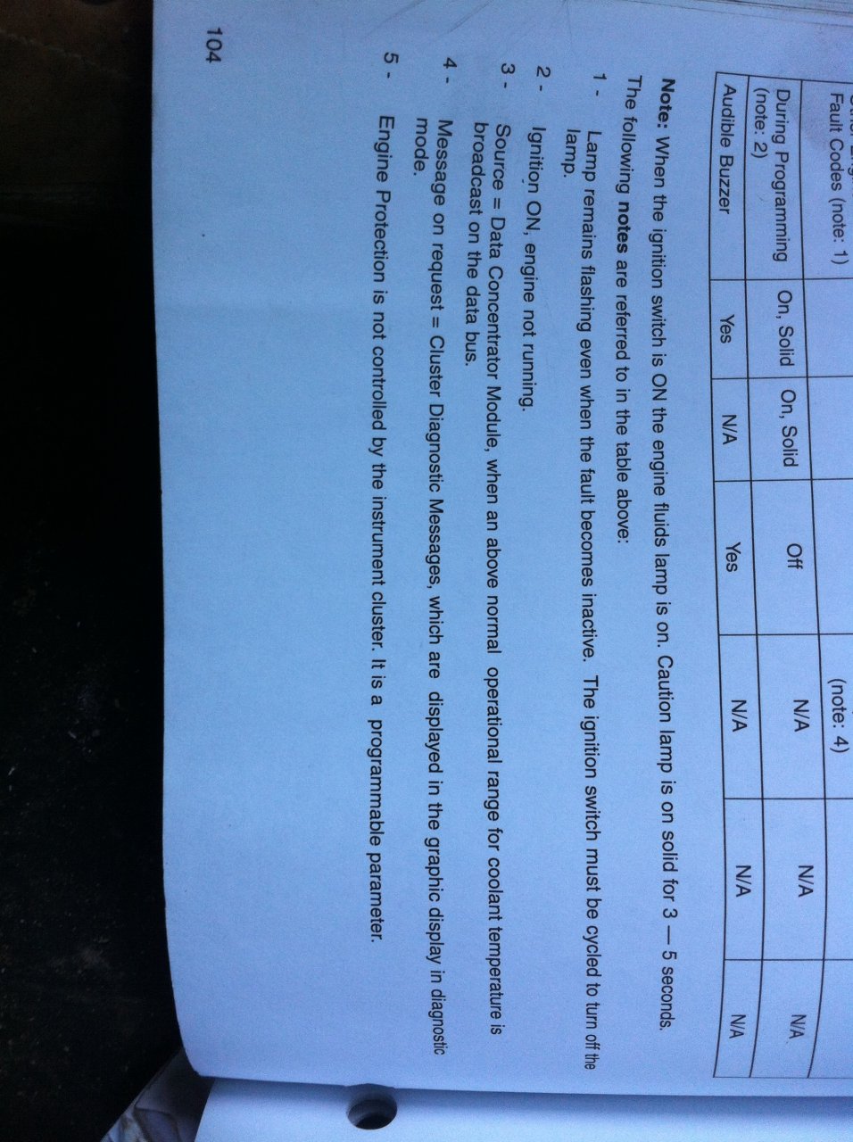

    According to the dash cluster test , I still have a wiring issue somewhere
