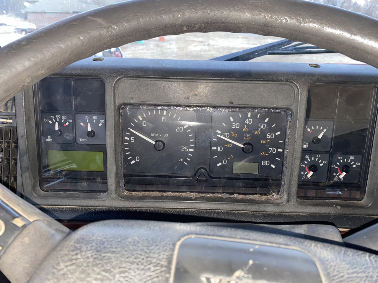

    99 Volvo VNL Single axle, M11, super ten. Former fed ex truck. Vin 4va7bapf0xn770xxx
    I have found an instrument cluster from a similar truck that is supposed to work. The bottom label of my cluster is worn off other than 1022829 REV 1998081 880. That number doesn’t pull up anywhere.
    1st question- is there a place online I can find Older Volvo part numbers?
    More questions- will the same instrument cluster work from a Detroit, Cat, or other engine? Will the cluster of the same era interchange? I don’t think these have to be programmed, but I’m not sure.
    anybody know what the part number is for the cluster with oil pressure, water temp, and clock on the left, both air and fuel on the right?
    I know I can send it off to be resoldered, but this way I’m not down while it’s being done. My odometer went blank last week and I’m not sure those guys can fix that anyway. Shipping is kind of a risk right now too.
    Thanks in advance for your response.
    jay

    D220510E-1805-43F9-B49B-BF751A1E8930.jpeg Is the difference the clock on the left? Do you know the part number I need to be looking for?

    You got old style cluster, the little display on the left most likely won't work when swapping.
    You can try though and see what happens, it won't hurt
