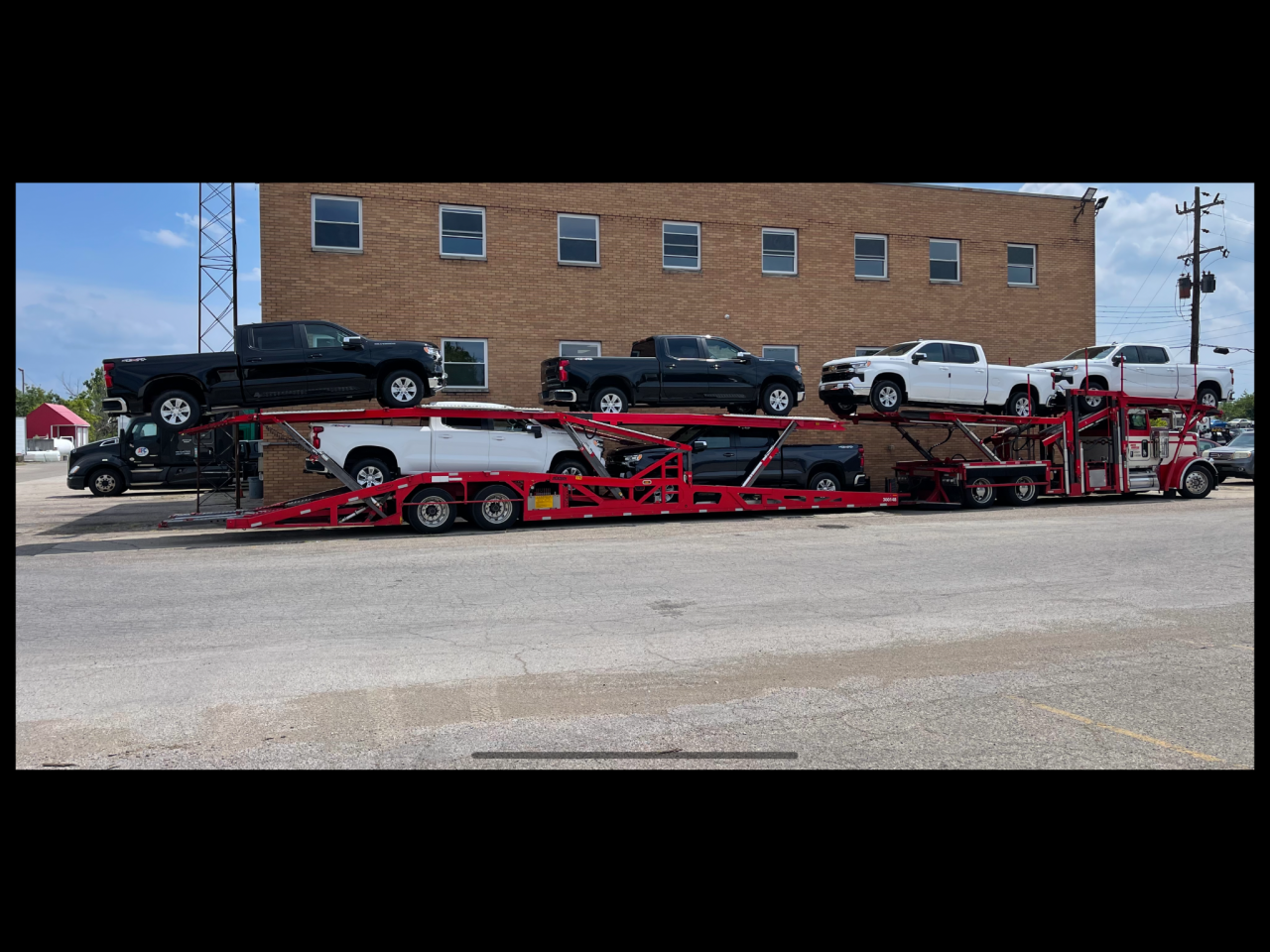

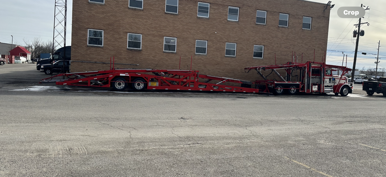

    bit of low bed here and there but mostly a fridge, didn’t really look that close at your Av to notice the rack honestly
