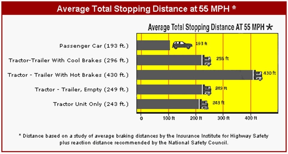

    92DF8673-0D67-4D63-8391-6695D53B2E4C.jpeg Found this picture shows an empty truck stops sooner than a loaded truck under ideal conditions.
    On snow or ice it maybe different. Certainly it is trickier when empty in the winter.

    I think we have got a bit off the subject here. The thing is a truck loaded at 75,000 pounds going 60 MPH is going to do some damage if it hits something. The weight and speed work against each other. I think the question is about stopping. Well, I have had empty trucks to slide and become a bit unstable and this, in turn, has caused some extra stopping distance. I never really like being empty or bobtail because of the truck always not settling in the suspension and the tires were not fully down. You can see this principle with some flatbeds and other drop decks with tires mounted so if the vehicle was empty the tire was off the ground. Yes, a truck that is loaded has weight. this weight adds to the force needed to stop it. However, the truck is built to handle this weight. They stop better and are more stable in doing so. I even have taken note of my loaded truck driving better in the snow. A loaded truck is just better all the way around. I see this subject has been discussed before.

    And bob tailing is worse than running empty correct? That’s what they told us as well. Loaded is best then empty then bobtail

    Yes, I always found I needed to apply more foot pressure to stop when bobtailed.

    I wish somebody would put this idea to the test, or maybe they already have, and it’s up on YouTube. Who knows.
    From my personal experience, you should be able to stop faster when fully loaded (80k) on a wet or icy road. However, I am not very sure if that would be the case on a leveled dry road. I am aware CDL handbooks say a loaded truck will stop faster.
    If you’re empty, and hit the brakes hard on an icy surface, the vehicle won’t stop at all. It will just slide. If you hit the brakes hard on a wet surface, the vehicle can jump repeatedly and slide, and it can travel a bit to the right or left. On a dry surface, the vehicle will jump repeatedly. Now, if you wanted to brake as fast as possible while empty, the key is to brake gradually. The wetter or icier the roads, the more gradually.

    It’s called a bobtail proportioning relay valve. It reduces service air going to the brakes when bobtailing, meaning you have to press harder on the pedal than you would when pulling a trailer to slow or stop.
