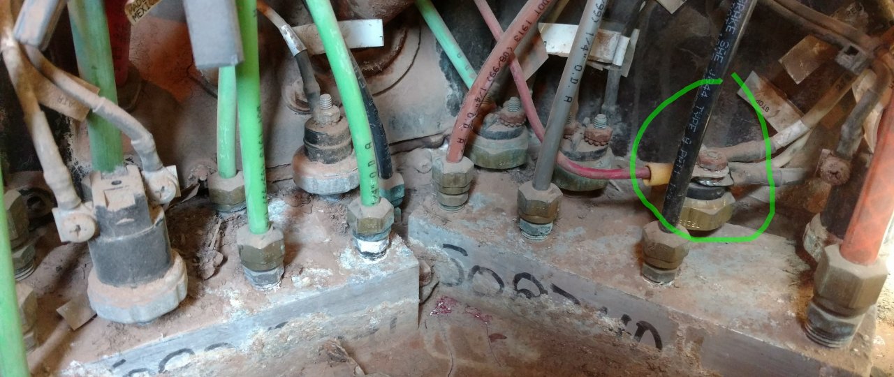

  8. greaseburner
    greaseburner Light Load Member
    155
    45
    brake light switch.jpg I'm assuming the guilty party is the shiniest brass one on the right circled in green.....
    If so, I don't know why the red lead is on it besides there was a possible past power loss on the original lead?
    Thanks
  9. Bean Jr.
    Bean Jr. Road Train Member
    5,338
    9,358
    Mar 30, 2014
    You are checking with the ignition on?
  10. greaseburner
    155
    45
    No, but that was the guilty party.
    Thanks everyone!
