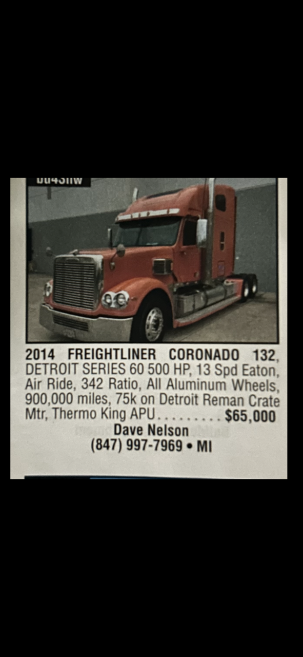

    CA0330D7-88D7-4807-A19D-CB1BC1972654.png Here’s an example of what I’d buy. Friend of mine recently bought one exactly like this one. Paid $90k. Unfortunately it has a piece of crap Fitzgerald built engine. Soon he’ll be replacing it with a $30k reman 12.7. Meanwhile his fingers are crossed. I could have warned him, had he asked. This one already has a reman engine. 900k miles doesn’t scare me a bit. It’s average for the age. It’s legit. The miles you’re seeing on the others aren’t legit. The WS had a new speedometer at overhaul. Probably has 2 mil or more on the Truck itself. That’s to be expected. I’d look real hard at that one. Inside out, and upside down. The others are bogus mileages. Expect at least 80k per year average on any Road Truck. Usually more like 100-125k per year. New Trucks have to run to make the payment. A 500k Mile 20+ yr old Truck doesn’t exist. This Coronado would be my choice if I were to upgrade from my Classic. It’s a bit higher priced for parts than mine. But it’s also a newer technology Truck. Built a bit better than the old ones. Still get all the benefits of good ride, available parts, and ease of repairs, having lots of room under the hood. Still somewhat simple, and overall everything is still newer than the 25 yr old Trucks. Just my opinion. Based on my own bias mainly. Also based on experiences with repair costs. The Coronado is a good bet. Parts will be readily available for years to come. Should you decide to keep it a long time. IMO the best of both worlds. A perfect compromise for a used purchase. The higher price will pay off in less repairs, decent mpg’s, and better resale in 4 years, while it still looks like a newer Truck. It’s basically the current equivalent of my 2000 Classic when I bought it 15 yrs ago.
