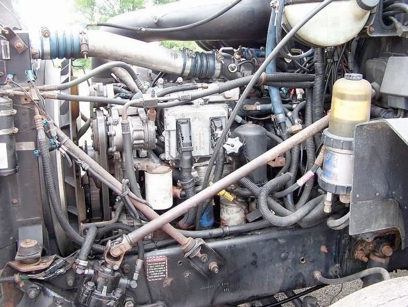

    Let's play..."Where's the Engine".... here's a Bulldog...
    I THINK I see it... all I have to do is remove those 15 lines...about four filters and thing-a-ma-jigs....a couple more brackets and i THINK I can see the valve cover...yep...there it is!!!
    So how much time do you think it takes (#$95.00 per hour) to run the overhead on this engine... time is money folks.
    Have you ever done a clutch job on a Mack? My local shop charges around $500.00 more in labor than with a Farmall, Pete, Freightliner... a KW is tuff enough with all the air control valves mounted on top of the transmissions.
    Here's a Pre-emission ISX in a 379...
    Which would be easier to work on?

    overhead by the book is a two man job timing marks are on the flywheel, about $300-400 at my Mack shop

    First we'll start with another left side... the guy who designed this should be shot! yes, it's a Mack...
    Here's right side shot...
    Here's a Pete with an N14... another pre-emission engine. ISX pix were kinda scarce...
    And another not so good...
    I think Stevie Wonder could tell which engine is easier to maintain let alone do major service on... with all apologies to Stevie Wonder...
    I am NOT knocking Mack trucks as a whole. What I AM pointing out is the difficulty of servicing them... if you do your own work be prepared to deal with the maze of wires and hoses and brackets, etc. that get in the way. These new emission engines are a nightmare to work on in the BEST of situations... tuck that last 1/3 of a cylinder head under the cab and you will be paying dearly for someone to repair and maintain the engine.
    Look at where that N14 #3 head is... you can take it off the engine without removing anything else...now look at the Mack... see that head?...I didn't either!

    your top photo is of a 04-07 ASET Mack filters are not all on the left side of the motor, and with the EGR valve its more difficult to service than a pre 04 ETech I have owned N-14 and E7 's the Mack is just as easy to service than the N-14 god forbid you have any computer troubles with the Cummins because it doesn't matter how easy the motor is to get to their mechanics will never be able to find and solve the problem also put the N-14 into a 9200 IH shorter hood and under hood airfilter then tell me how easy it is to work on a N-14
