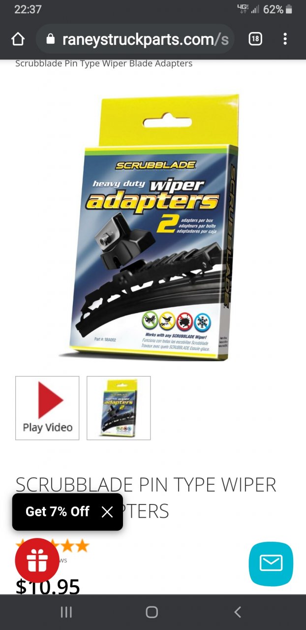

    Thats from raneys, not sure what your arm looks like exactly but both my brother and my trucks were the tapered insert.its basically what you use to set how far one way or another the blade goes
    Highly recommend a small gear puller, i used a small valve stem compressor i had from working on my subaru or camry

    Actually those dont look like they will work either, says only for use with "scrubblade" wipers... ive never even seen that style mount. I dont think there is a place in my town that even sells those brand wipers. I'd be stuck in same boat, hunting for place that carry wipers. I want to use the standard ones every car and truck use so I can switch to winter wipers in winter and back, and if one breaks can buy anywhere.
