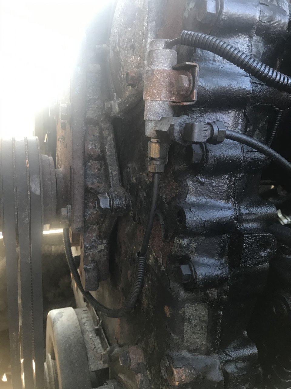

  4. Jasonar15
    Jasonar15 Medium Load Member
    669
    519
    Aug 6, 2017
    Take air supply off fan solenoid and see if that shuts the fan off.

  7. Jasonar15
    669
    519
    Aug 6, 2017
    It’s a small cylinder looking device on front of gear cover with air line going to fan clutch. Remove side going to clutch. If fan disengages could be a stuck solenoid. I can’t remember if air engages it or not but mine done the same thing and changing that fixed it

  11. Jasonar15
    669
    519
    Aug 6, 2017
    This is how mine is. Electrical connection to air solenoid that engages/disengages fan
