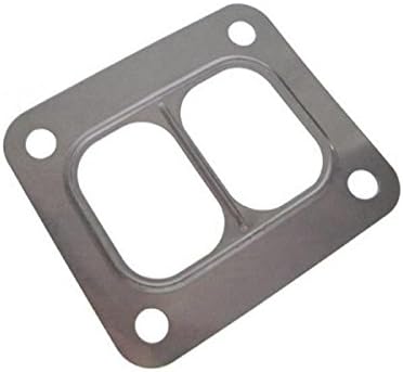

This is the turbo I purchased BorgWarner 171702: S400SX4 Turbocharger 75mm / 2.94" Compressor Inducer Dia. | JEGS s400x is supposed to be a slightly improved 171702, I don't exactly know how but it's worth trying, also make sure to buy
Divided Twin Scroll Turbine Housing gasket from amazon it's only 6bucks, the original gasket that comes with the turbo isn't divided in the middle, its open

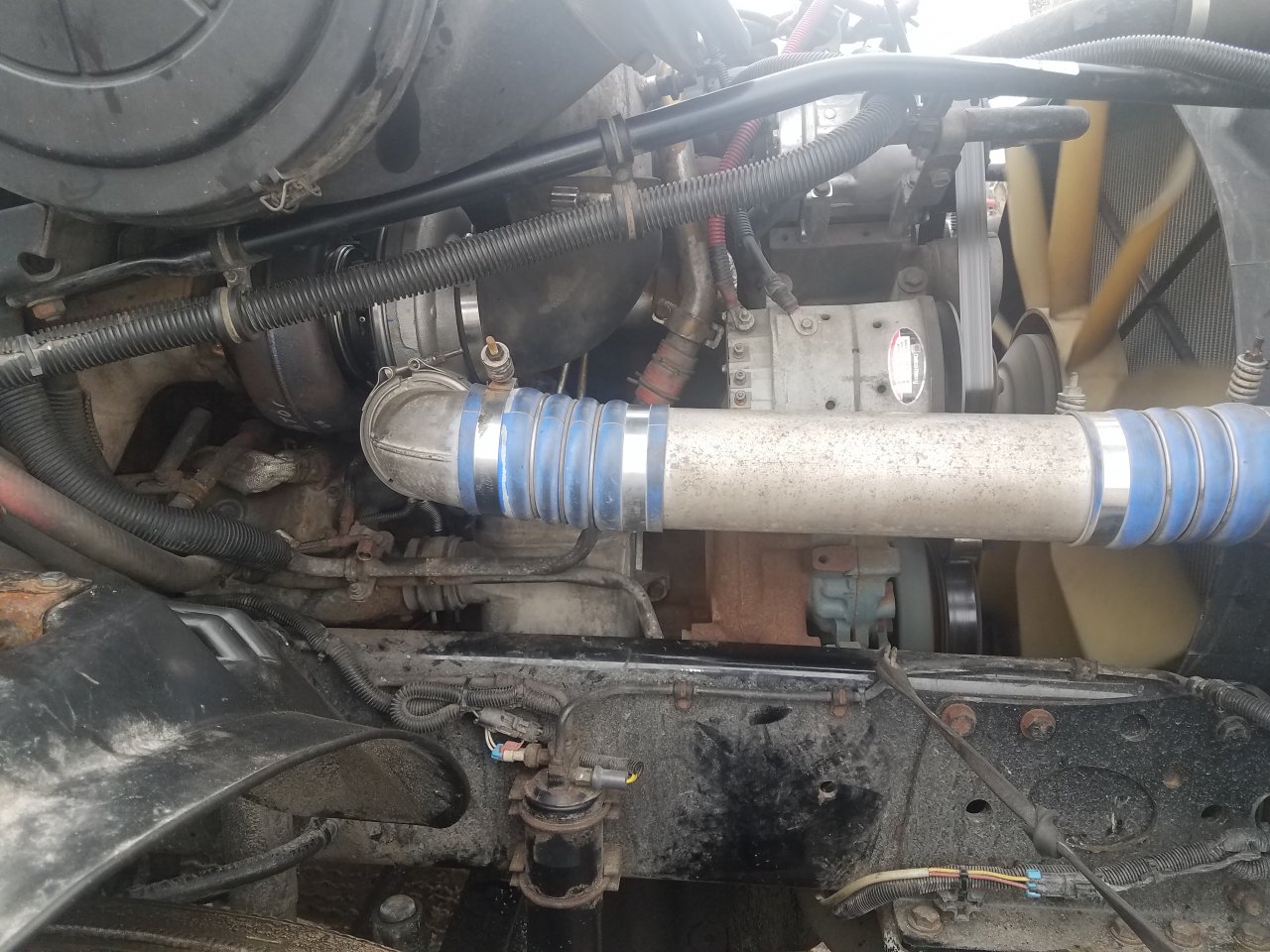

UPDATE: Everything went great (so far), just got done taking the truck for a spin around the city with a Empty trailer and I immediately noticed a huge difference.
First the turbo spools up faster and it takes off like a monster, theres a huge power difference than before, the truck is no longer sluggish and slow to role of stop. Only thing left is for the turbo blanket which I'll install tomorrow when it arrives.

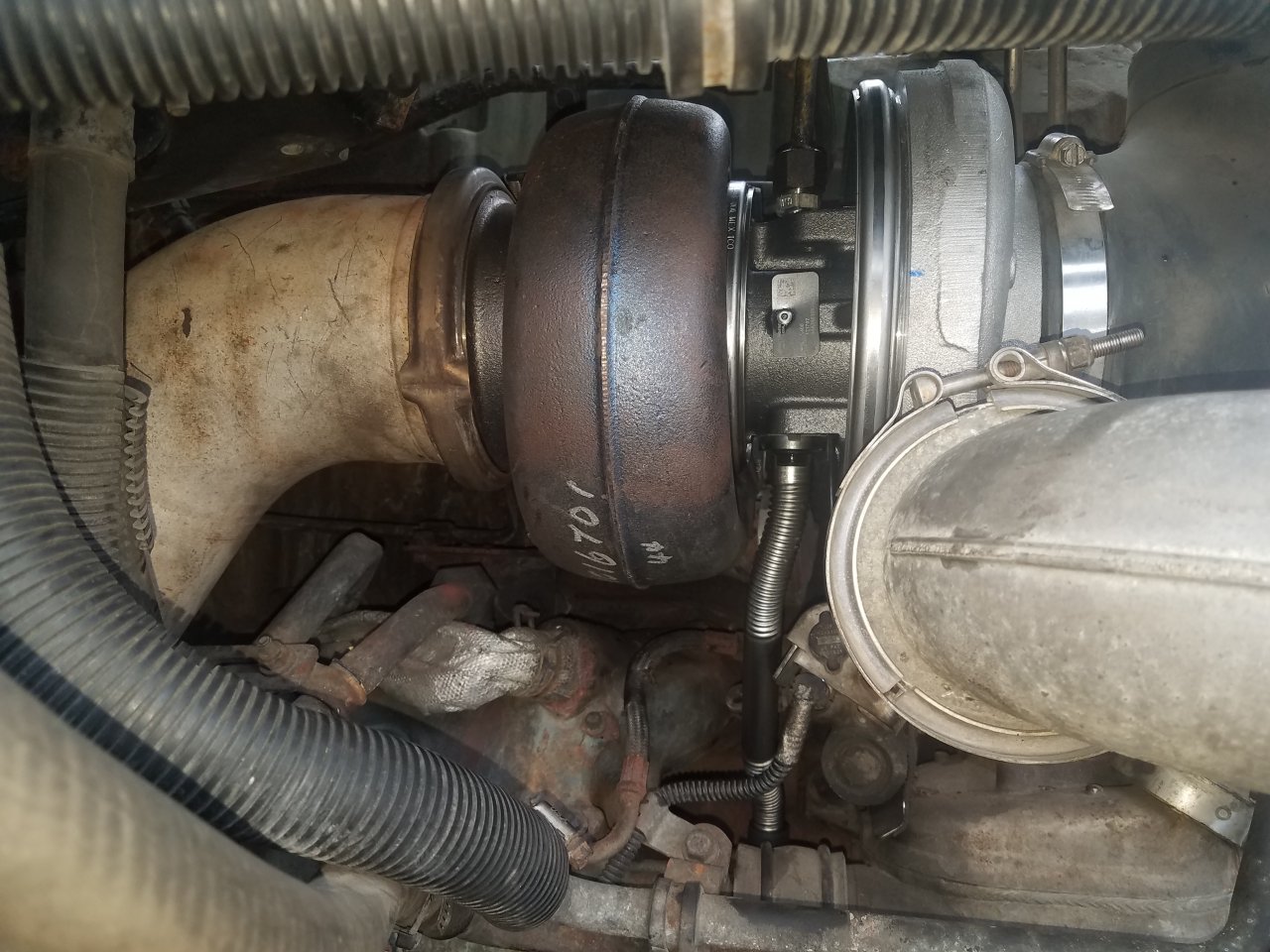

Buckeyes614, I'm curious about your turbo drain tube. Is that an application from older style tuve? Please explain if you don't mind. Thanks
you can use the stock drain on the 171702
So it looks like they left all the EGR stuff on. I like that route, at quick glance it looks stock.

Yes it's a old style drain tube from a 2003 12.7
