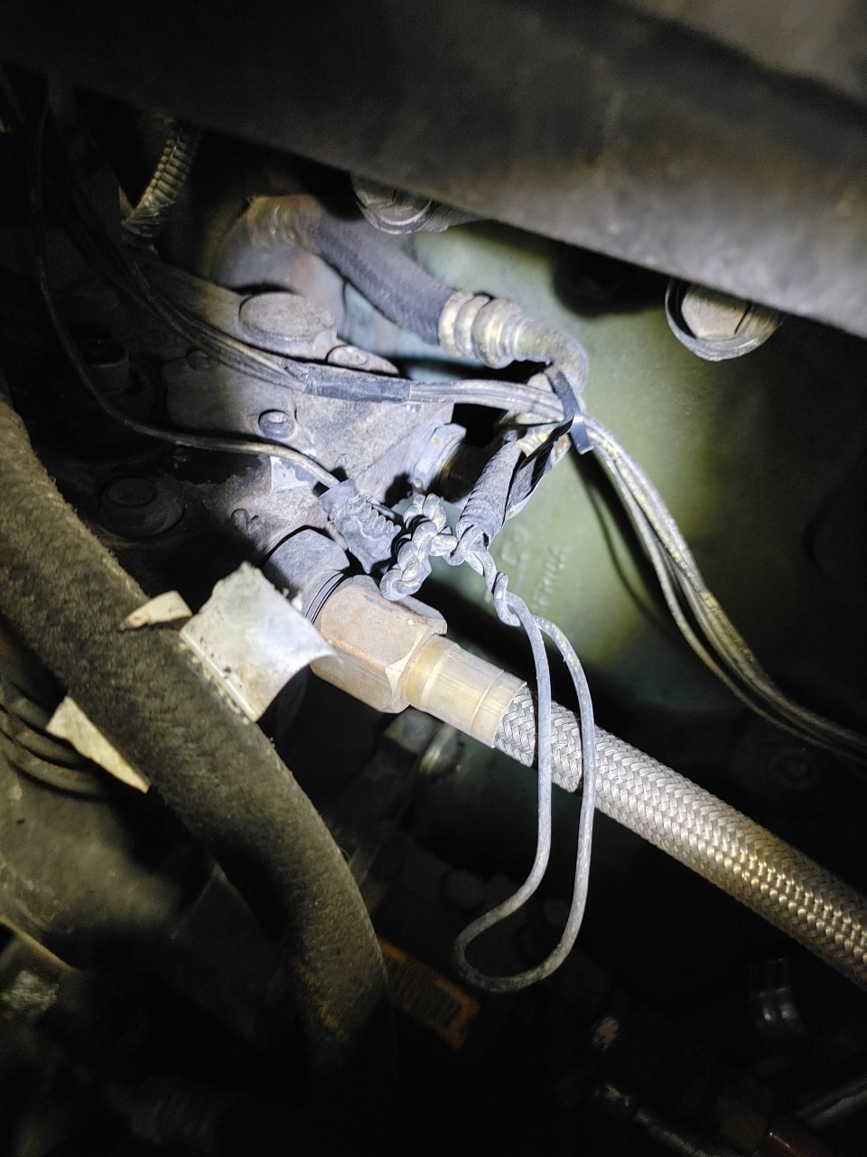

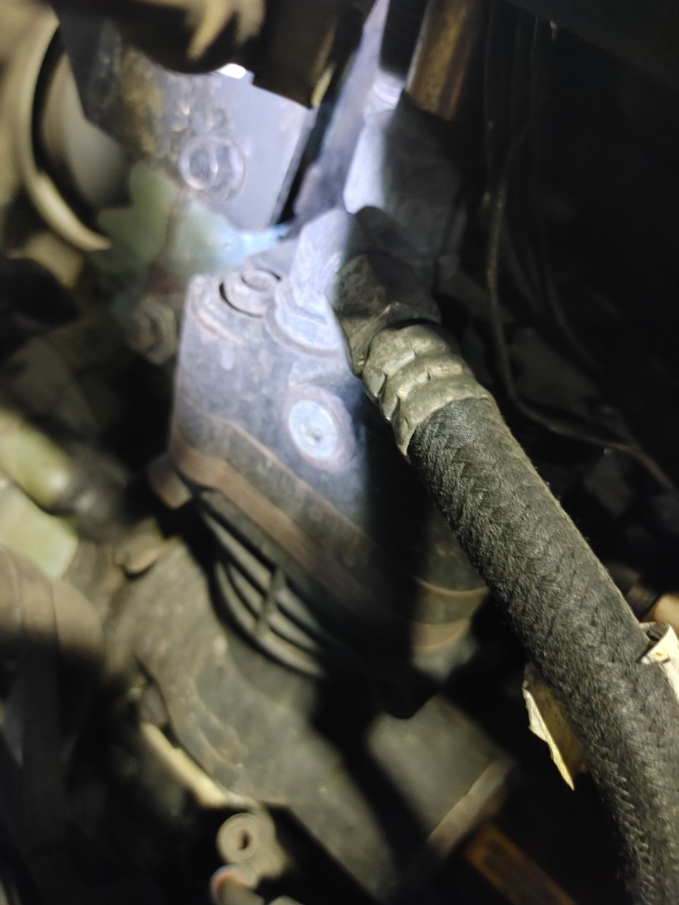

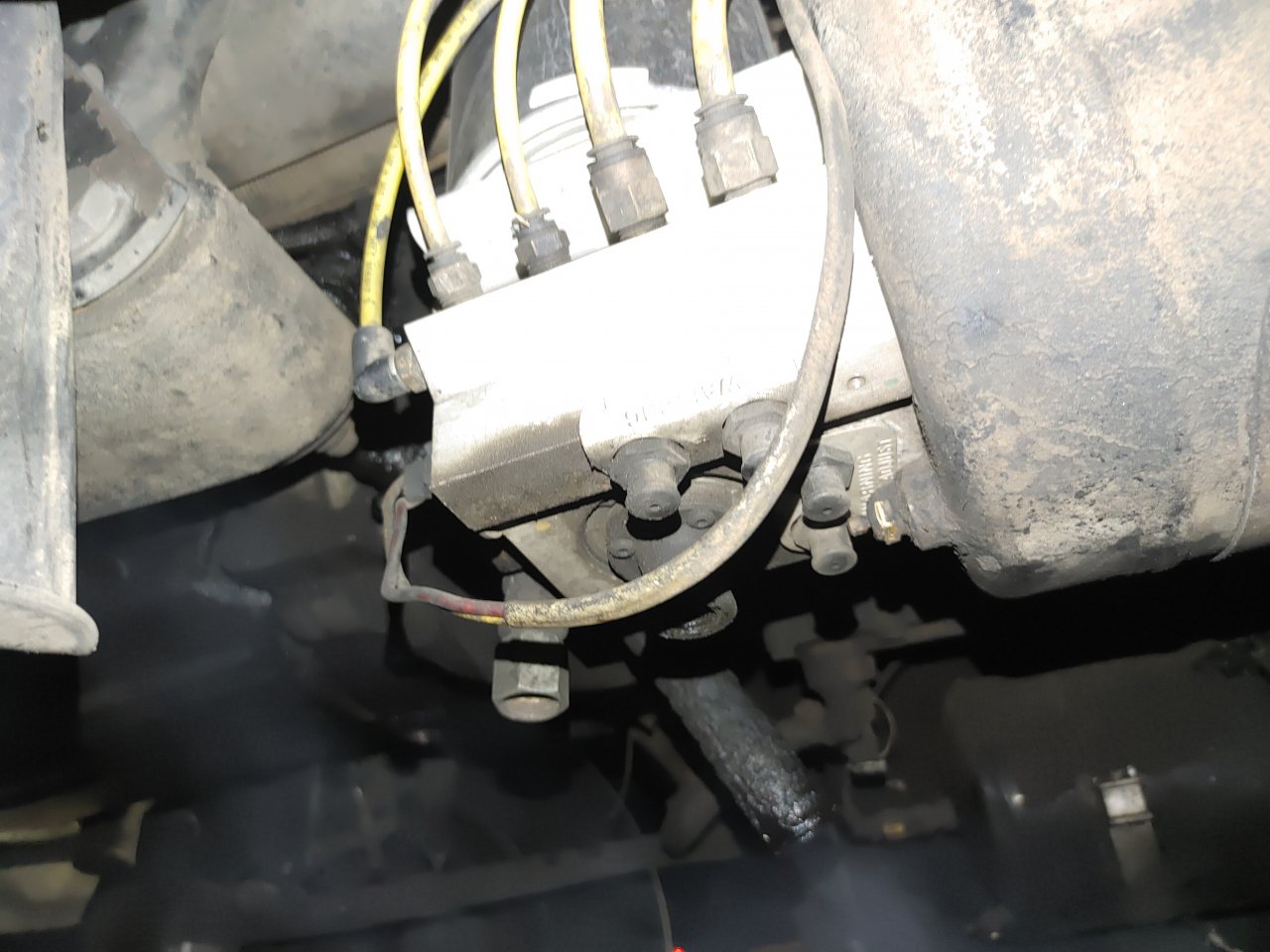

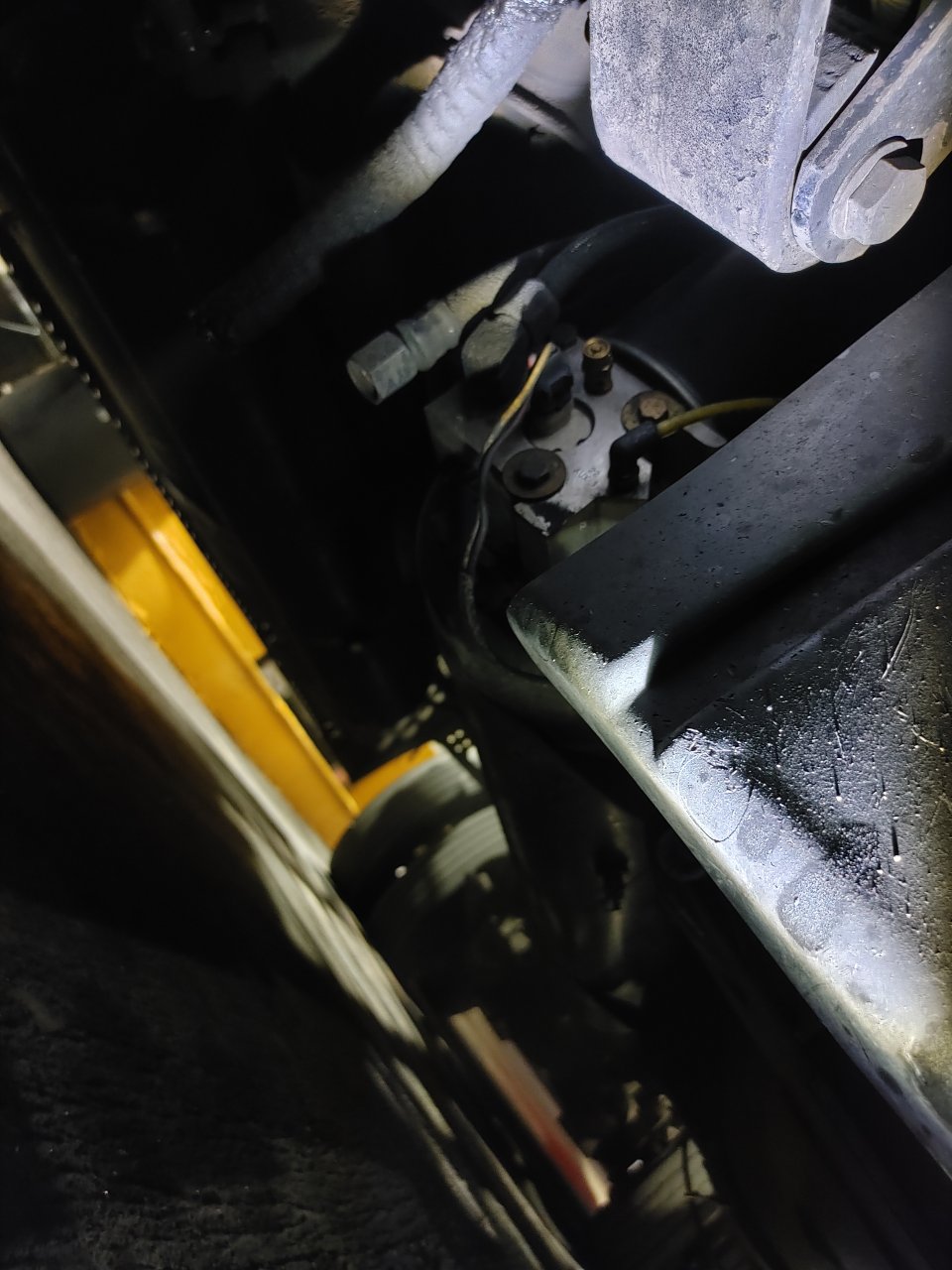

    the govoner is on the very front of the tank

    I have limited experience with those. Some one else can surely help you with that more than I now that they know what you have.
    Make sure the small line from the governor to the compressor is not stopped up. If you unhook that line from the compressor at 135 PSI and it has air to it I believe the compressor is at fault.
