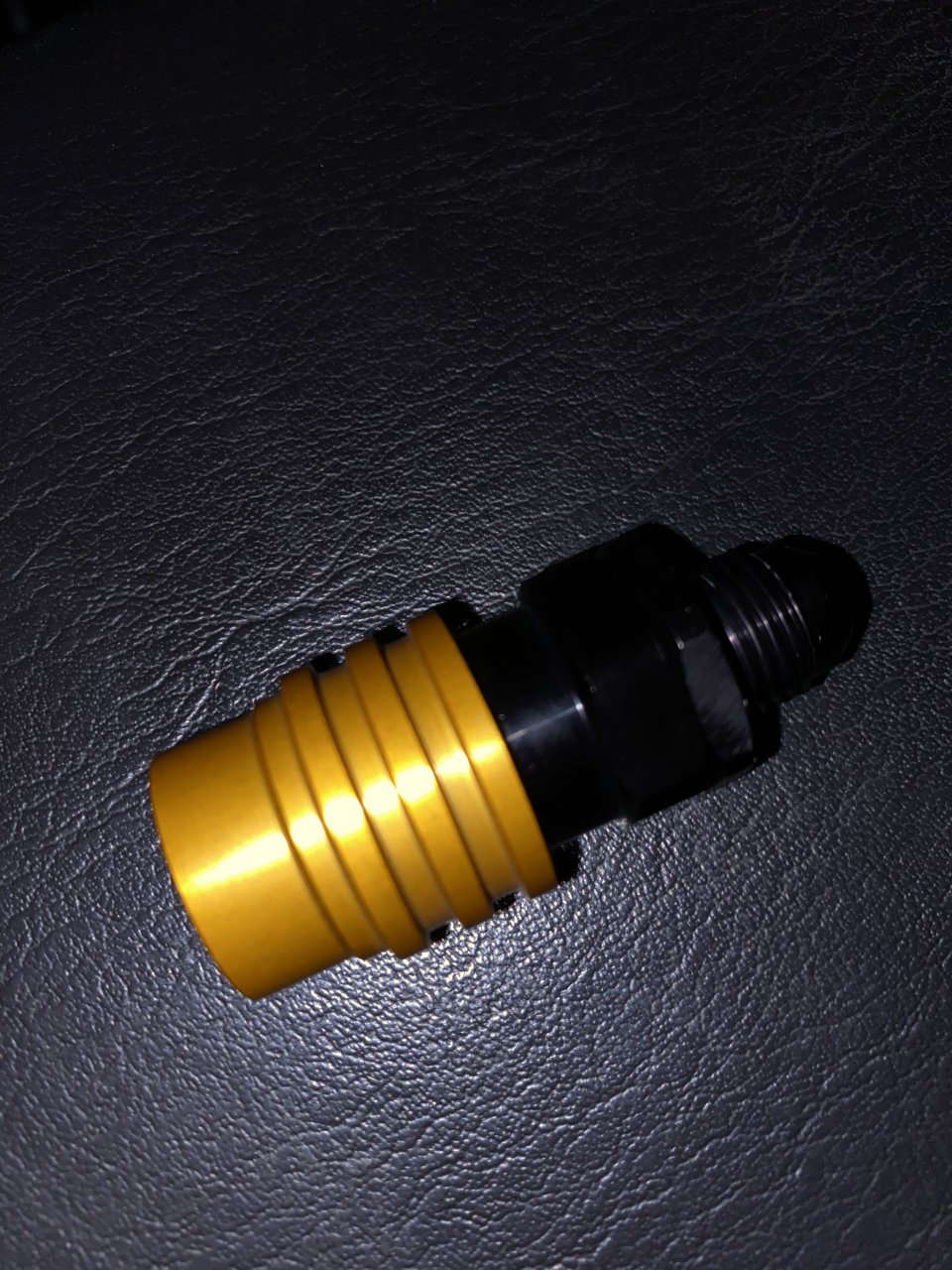

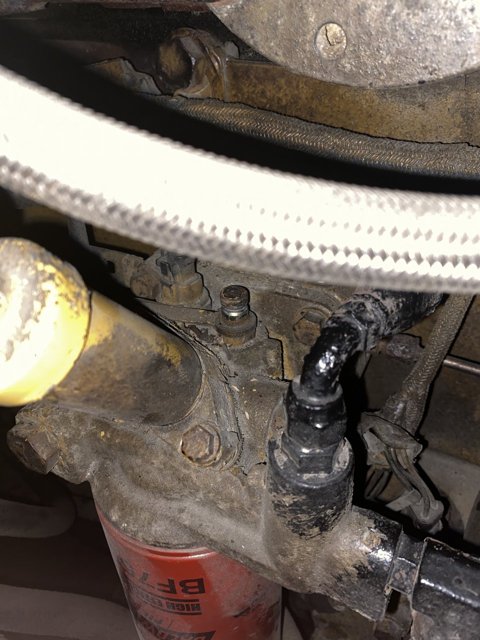

    Looks like there is a compucheck fitting behind your hand primer pump. Pop the cover off and get a compucheck quick disconnect adapter.

    Am I able to just take the fitting off and install something. I have a fuel pressure kit from harbor freight.

    You will need a compucheck coupler attached to a fuel pressure gauge. Any hydraulic hose shop should have what you need or atleast be able to order. You can take the fitting with you to match.

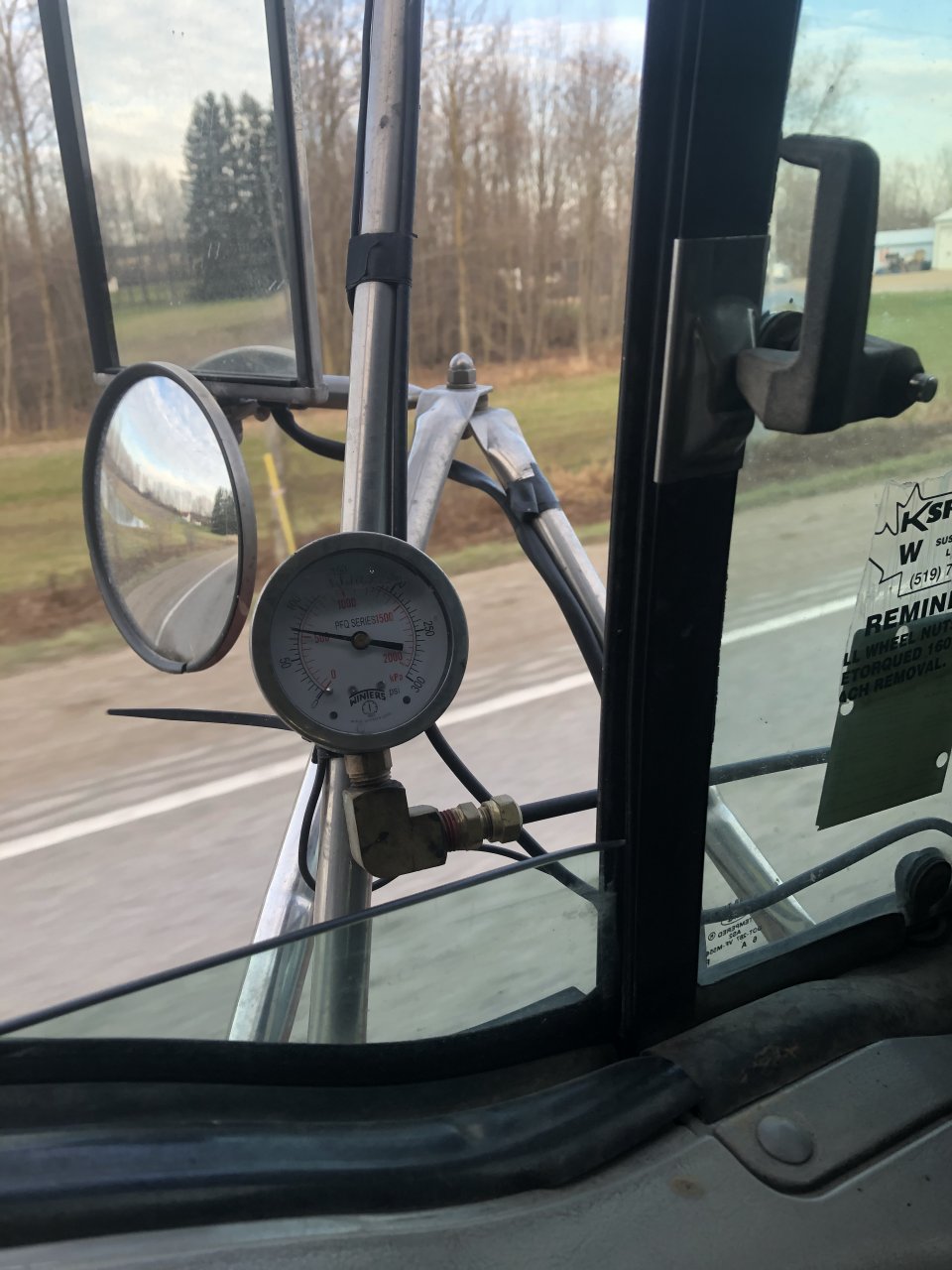

    This is how I set up the fuel pressure gauge when I’m looking for running issues with this 3406E.
    I have it on right now to help with starting issues.
    I went to a hydraulic hose shop to get a fitting to hook the hose to.

    Everyone I talk to says it’s a dealer part

    Not nearly. Google compucheck coupler, you can get them anywhere.
