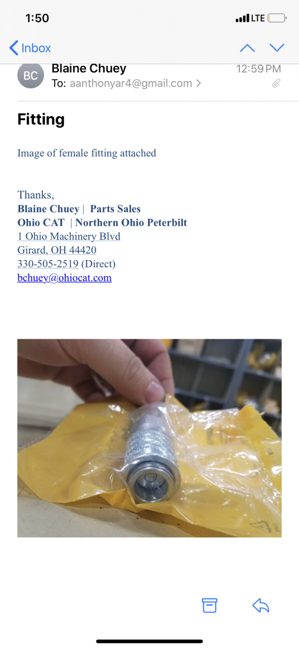

    Also this part did not work. It was a few thousands off and leaked fuel. Went to my local industrial connection had to thread an adapter in place of standard quick connect.

    I got my pressure readings. 80 psi at idle I have it set for 750 rpm idle. Also I decided to go into the bleeder on the left of housing as it doesn’t suck air into the system. I couldn’t find a compucheck fitting till I figured it out CAT has the part and it will save tons of hassle. I just made a brass assembly that fit into the bleeder

    Compuchek is a tool brand used on engines of all sorts. My bobcat has them, my cummins in my truck has them, my massey Ferguson tractor has them, etc etc.
    Also you don't need to buy the assorted expensive gauges for compuchek. Just get the female fitting and pipe it to an accurate pressure gauge.
    Another note. The fitting at your primer should be able to be used to prime the fuel system with an electric fuel pump. That's how I prime my Cummins after changing fuel filters or any other time I've opened the system up.
