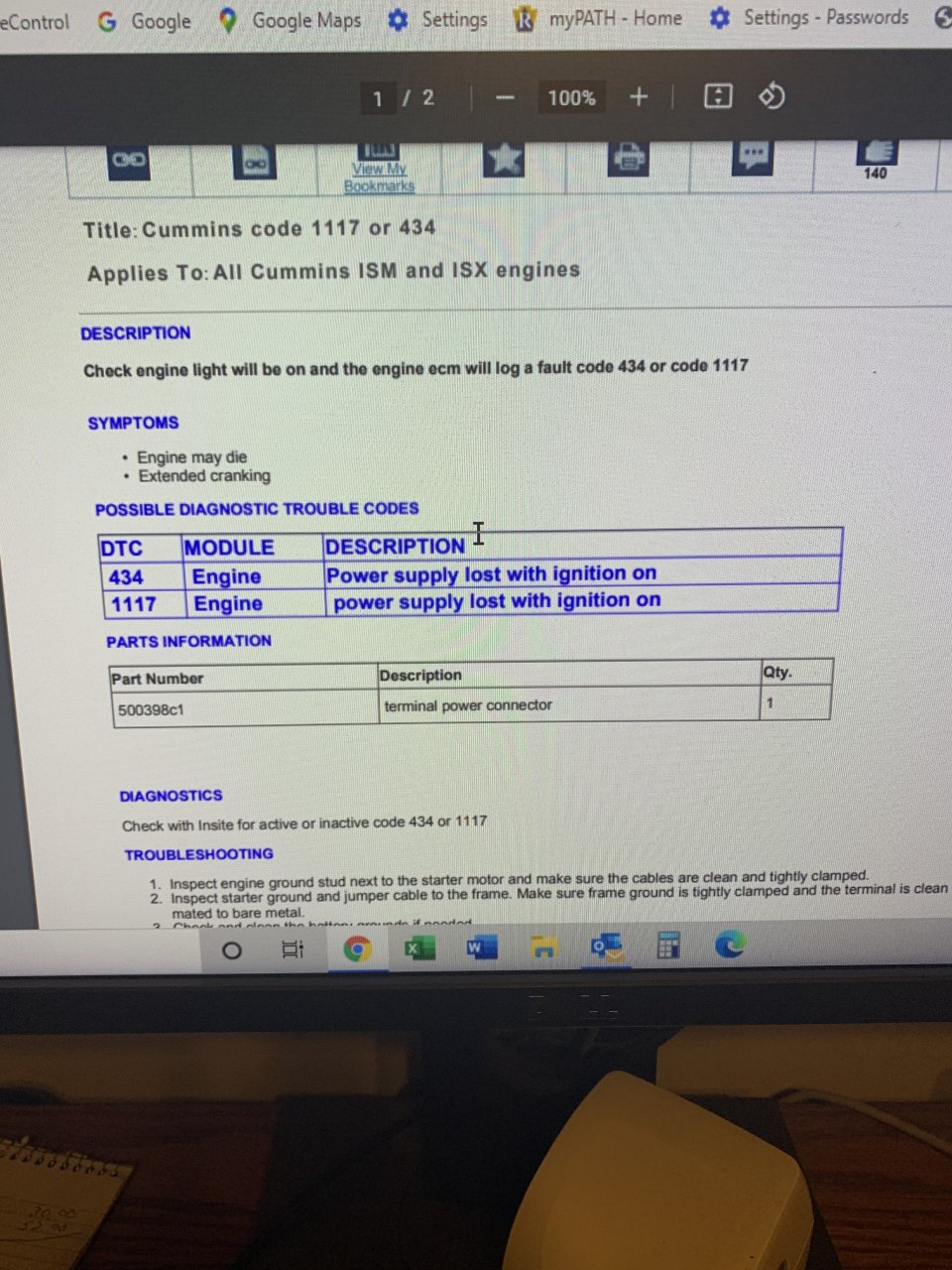

    Mar 14, 2021
    Heavy D, I found a article that the national transportation safety authority put out about my problem. I will post the safety bulletin as soon as I get my daughter to show me how. LOL
