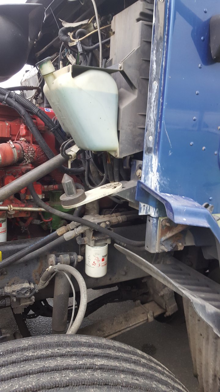

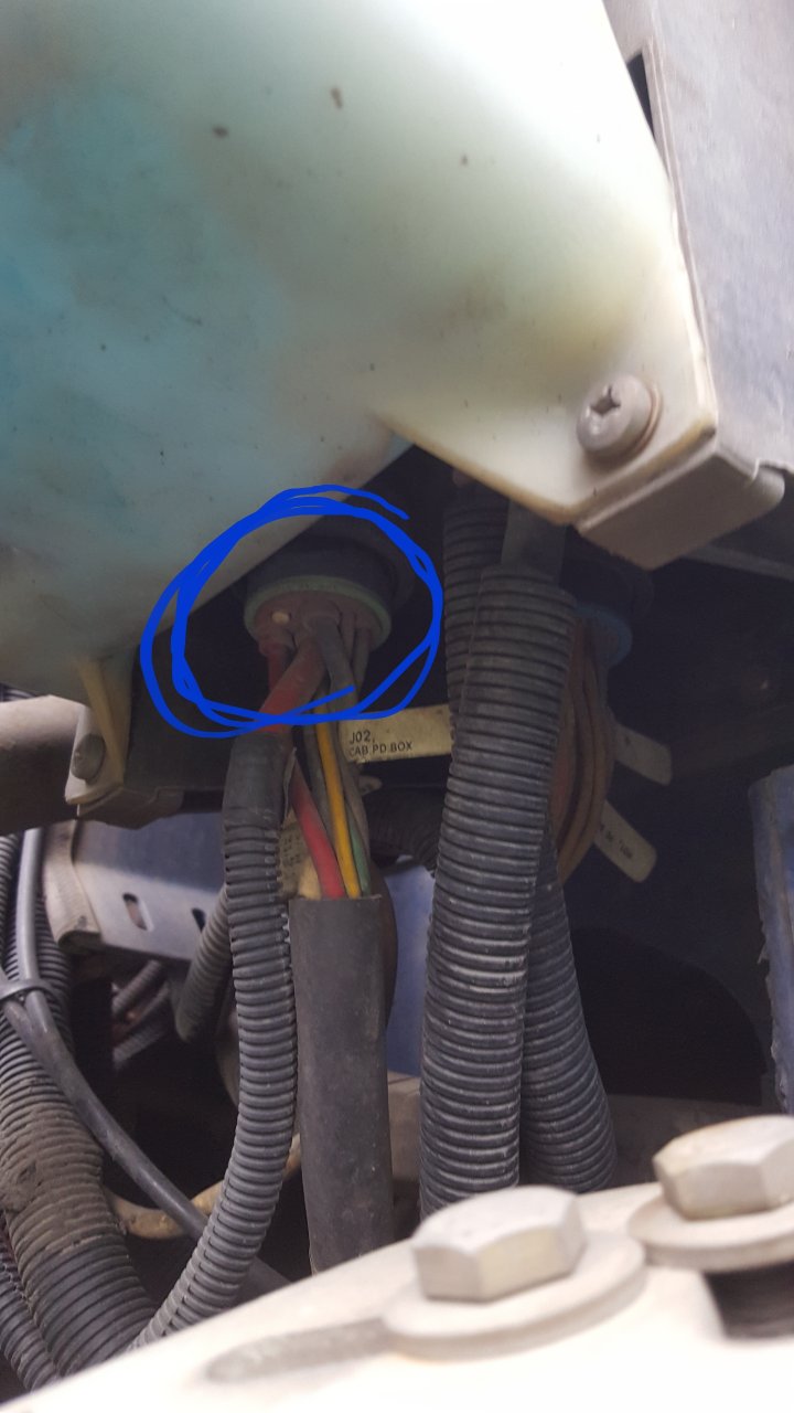

All my lights work on my truck.All the running lights work on the truck and trailer.My pigtail is good.Fuses are good.The problem is .I have no 4 ways and turn signals on the trailer.Any ideas have to solve this issue? I have a 13 t660 thanks
Do the turn signals work at the pigtail?
Unscrew that connector and check the pins there. That connector is the opposite end of your pigtail. Find the pins that correlate to the yellow and green wires on that connector (left/right turn) and check the little pins.
Ok bet will do it now.But would both sides come out at the same time?
