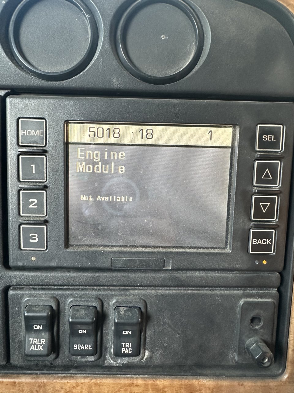

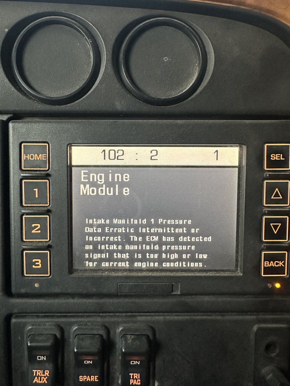

    I have an international Prostar with Cummins isx 2010. while driving loadey it shows the stop engine light & loose power for 3-4 minutes then become normal. Mechanic had changed its egr valve. Had spent $ 3500 on egr but looks useless. Stayed normal for one day after egr valve changed then again same issue started. When loose power through codes 102:2 & 412:15. When got power back then codes become inactive. Plz help me out for the issue. Today it through new code 5018 :18

    "You have one code for the EGR temp too high. You likely have a plugged or fouled egr cooler. The other code is for the intake manifold pressure sensor too high or too low. I would fix the EGR problem first before going after this one. The 5018 code is for DPF temps not increasing during a regen. This may be due to failed DOC or aftertreatment fuel injector. I would still fix the EGR code first before this one too."
