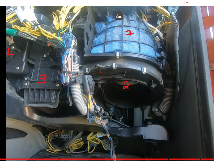

    This video is for a Columbia.
    (1) Freightliner HVAC blower motor. troubleshooting, diagnosis, repair - YouTube
    1- is an air filter but there should be the one for outside air. The one you probably changed.
    2 - is the heater core
    3 - remove those screws to see what is behind there. Likely the blend door.
    4 - this looks like a servo motor to operate the HVAC blend/direction door
    Note the thumbs up/thanks icon near reply.
