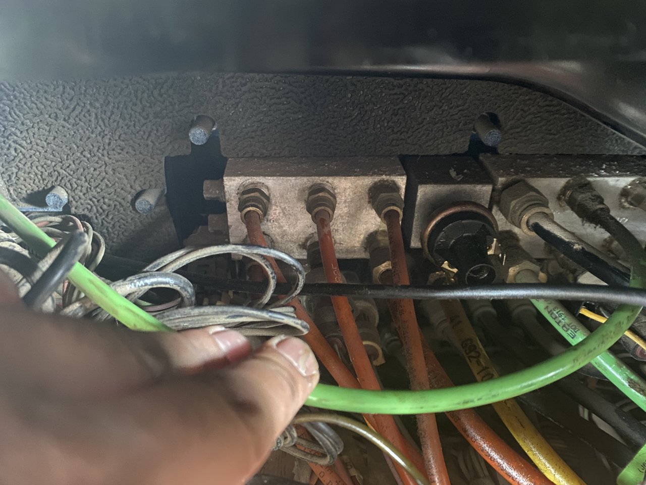

    I have a 2010 Kenworth W900 and while I was driving the parking brake light on the dash and buzzer started to turn on. My air pressure is good and everything seems fine. Is there a sensor or switch and where is it located so I can change it out even my cruise control stopped working

    Yes. It's called the brake pressure switch. On mine it's behind the right Guage panel, but I have a 1994. It is a PITA to get to, so I paid Kenworth to have a guy work his fat fingers inside.

    I was a pain in the ### ended up breaking the top part of the switch just to loosen the nut, but in the end problem solved. It was in the dash
