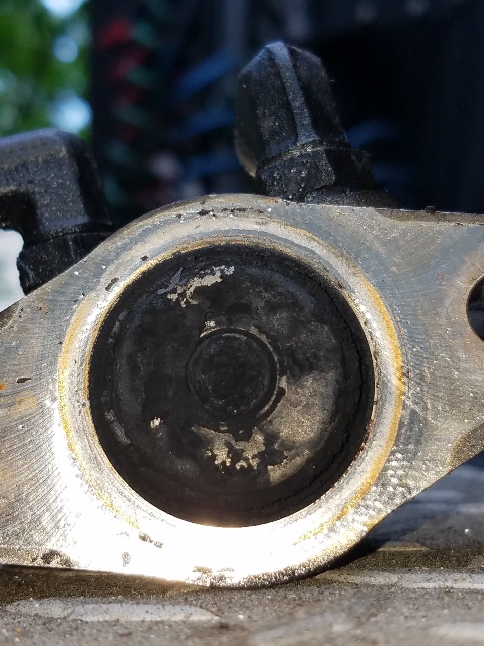

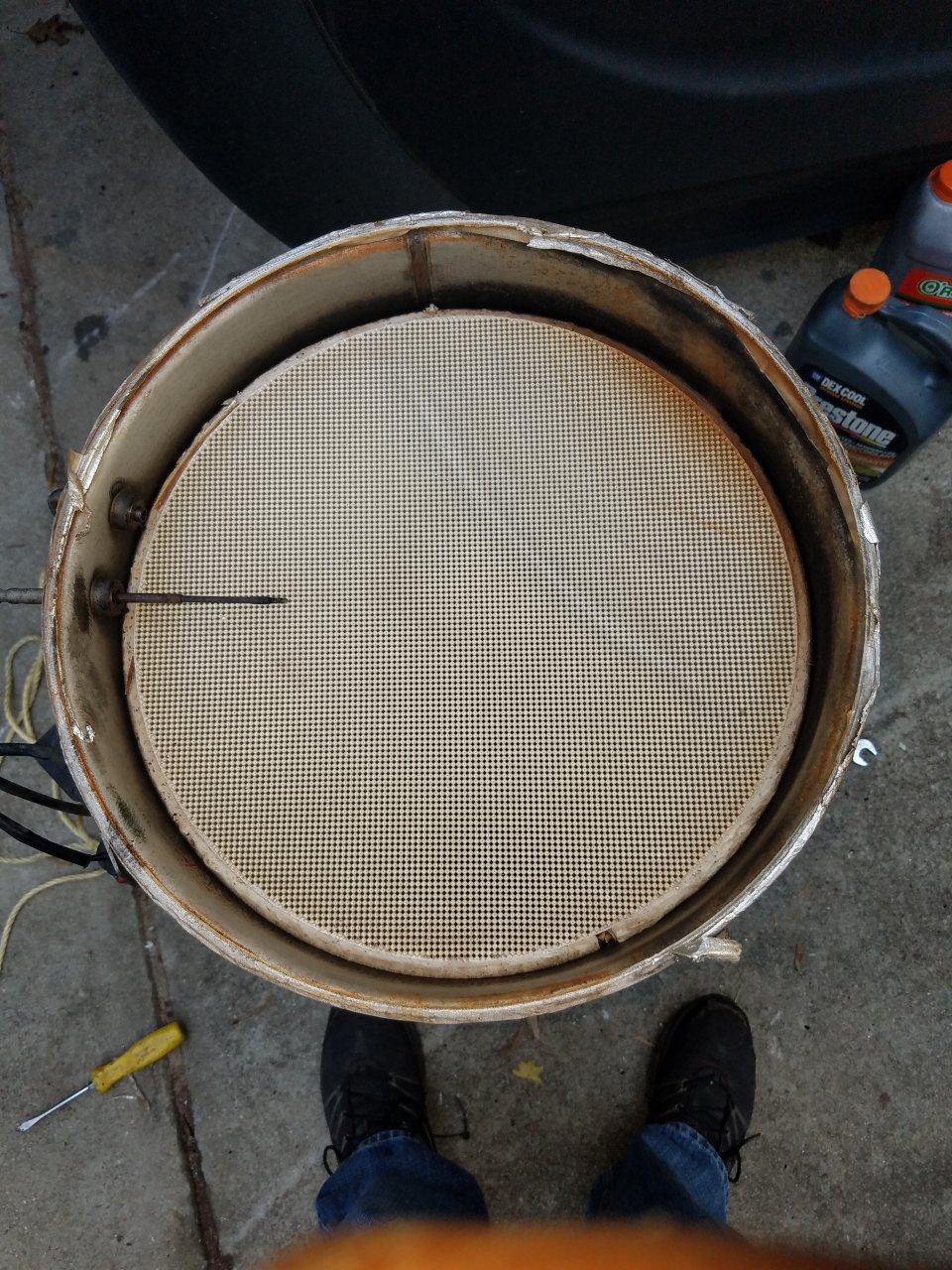

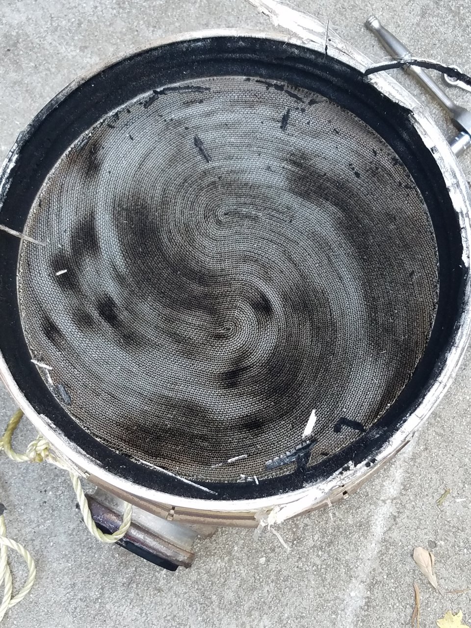

    You can use regular high temp tape for gasket between the sections. That carbon dam in the exhaust pipe also most 100% covered over! There's your problem! You can just poke that out with a screwdriver, those carbon flakes won't hurt anything. The bore hole size is about the size of a quarter or a tad bigger. The DOC and DPF look typical. Should clean up nice. Make sure you antiseize all your threads for the sensors, clamps and bolts so it all comes apart nice next time. You can clean the underside of the doser with a nylon or brass brush.

    Thanks. They said the dpf was 90% full. Put it back together, and test drove, she sound quieter, and seems to have power restored. Why is that doser valve gasket $49? I gather they trying to recoup money for the lawsuits...lol
