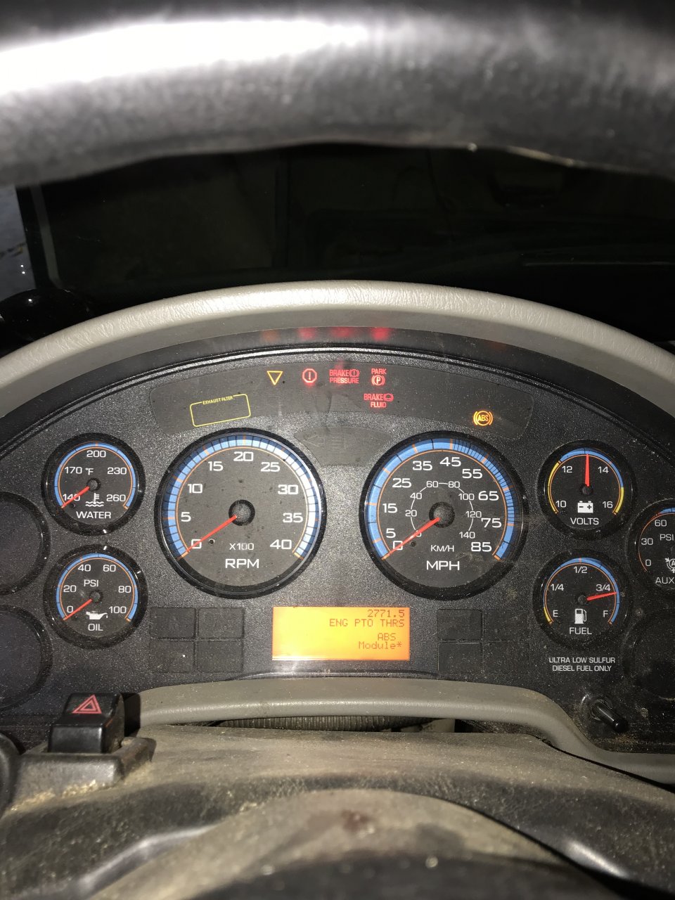

    Here’s what I have

    You probably have Meritor Full power hydraulic brakes. You'll need to see what codes are being logged for that. Probably don't have the electric motors running at key on to charge the accumulators. They are powered by big 30 amp fuses. There are two of them. They are in different locations depending on the configuration of the truck. Check near the batteries, and at the firewall on the left hand side.
