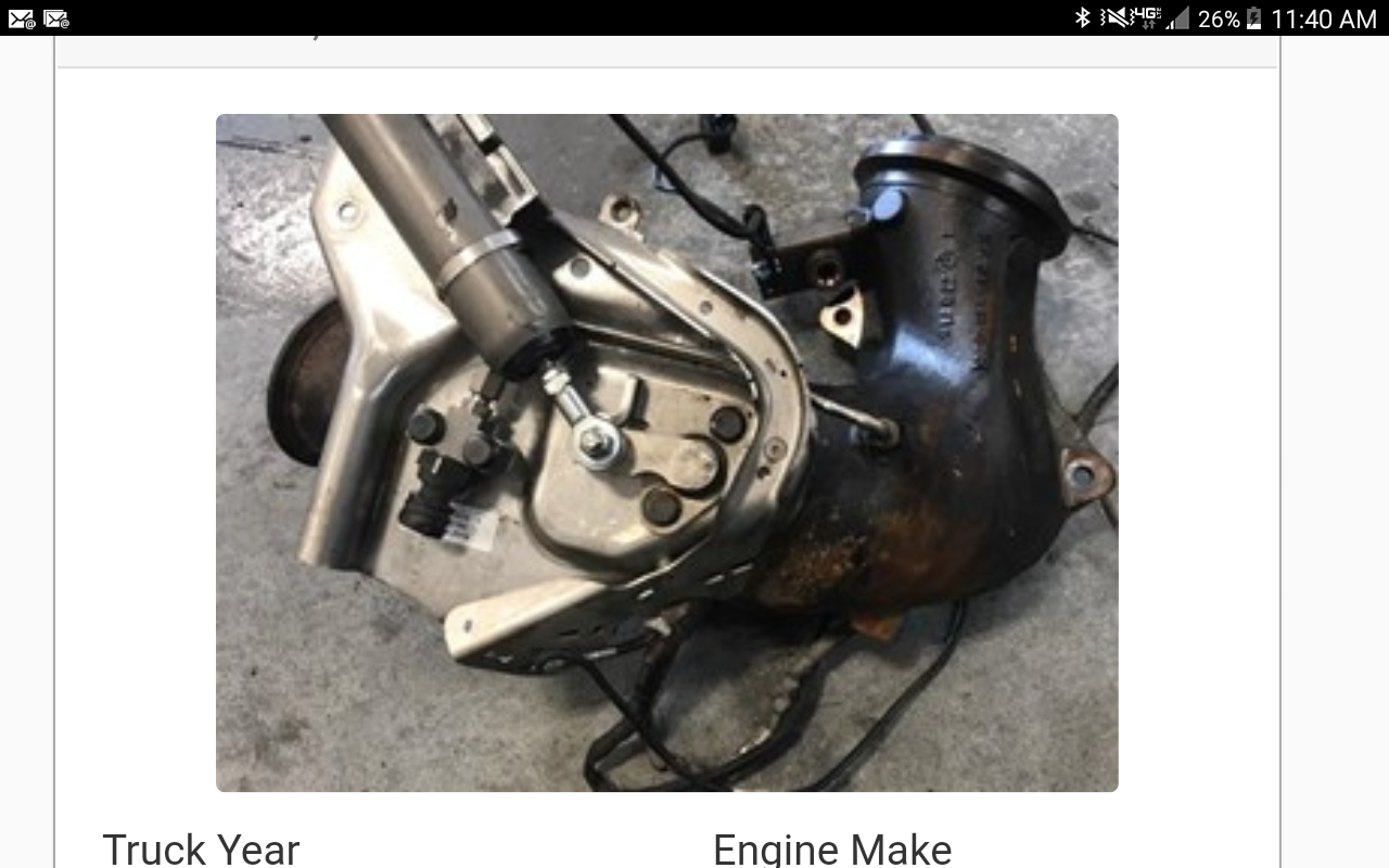

    If that's the case che k that exhaust brake to make sure it didn't get stuck closing off the exhaust.

  5. Tropsnart
    Tropsnart Road Train Member
    1,130
    2,385
    Jun 8, 2015
    Pavilion New York
    2012 exhaust brake actuator with 7th injector for a Paccar. I bet the actuator is stuck.

    I just said the same thing to the shop manager where the truck is.... fingers crossed that is the problem. It matches the two codes that we are getting, one for the engine brake and one for the bpv.

    Frustrating but that should be a relatively inexpensive repair compared to a new turbo

    Just wanted to update this thread and close it out. The shop found the problem just minutes after I showed up with my rental truck to get my trailer :mad:. Turns out that some insulation material from one of the parts that fell off of the truck got stuck in one of the metal screens in the back part of the exhaust system and was blocking the exhaust. The shop tech disconnected the exhaust behind the manifold and the turbo started spooling up right away.
