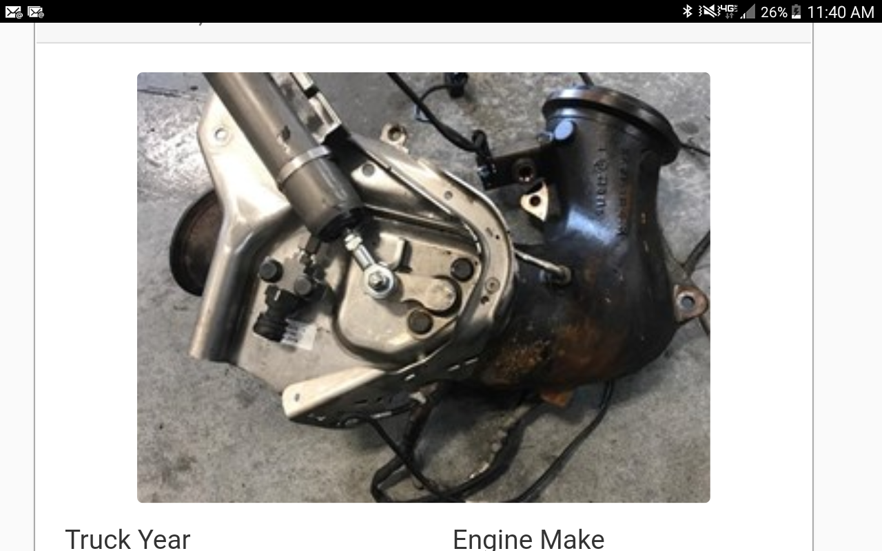

    That cylinder on mine is bad . Anyone has any idea where to get just th cylinder? Dealer wants 1500 for the whole assembled

    The air cylinder should be avalible from paccar. Whats the last 8 of your vin and I can get you a part number.

    Hey I had it ordered from Ohio and overnight it here since my local dealer wouldn’t sell separate . Fixed check engine .
