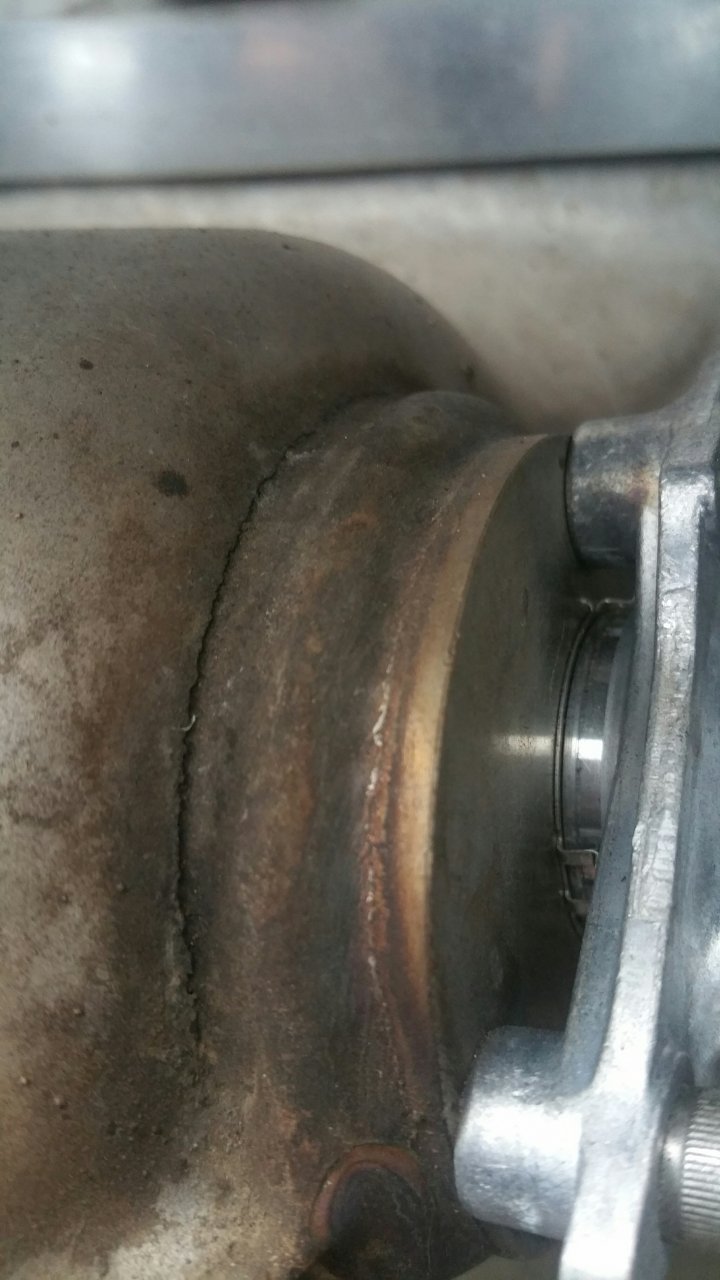

    Here is a fix I found for code 5394 17 right above the Def doser where they welded the flange mount it cracks at the weld and introduces air in the system and changs the chemical reaction the system uses for cleaning.Be careful when welding so you don't burn a hole in the pipe and use wire brush to clean surface thoroughly before you weld.After it is welded you then run the sublimation test and then run the dpf regeneration next this should clear the codes and fix your problems make sure you do 4 drive cycles to verify repair my name is David thx

    Jan 6, 2018
    20180104_093233487.jpeg Here's a pic of the pipe
