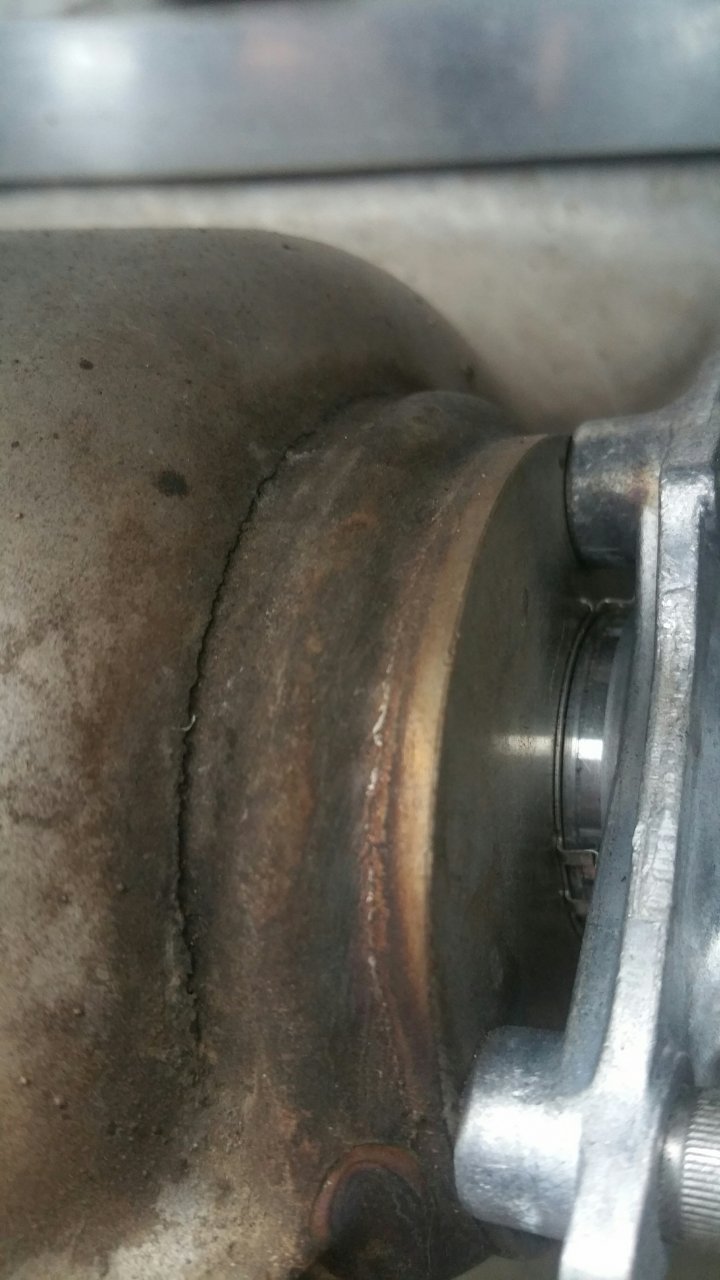

    I've been having the 4094 FMI 18 code while driving through Wyoming. The first time it cleared itself, the next 2 times it asked for a parked regen and it cleared, and this last time it cleared itself. It seems like about an hour of letting it regen clears it, or an hour of driving. I'm wondering if the DEF is freezing and plugging things up, or if I've got a sensor that just hates Laramie or something. I do plan on having the SCR and DPF ultrasonically cleaned. The ACM, pump, DEF doser, 7th injector, EGR cooler are all under a year old.

    Yeah, hopefully the cleaning will help it a bit. At the very least it should help the filter. What does the SCR look like? It should be like a disc or cylinder at the inlet to the DPF filter, right? Does anyone happen to have a part number?
