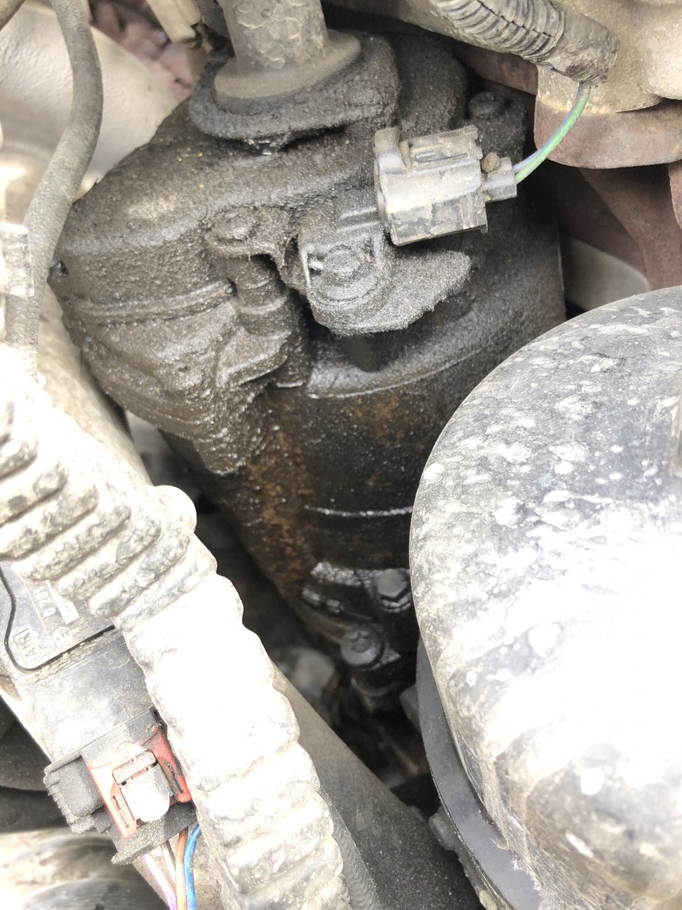

    I believe this is the actuator picture.. there’s a lot of oil there

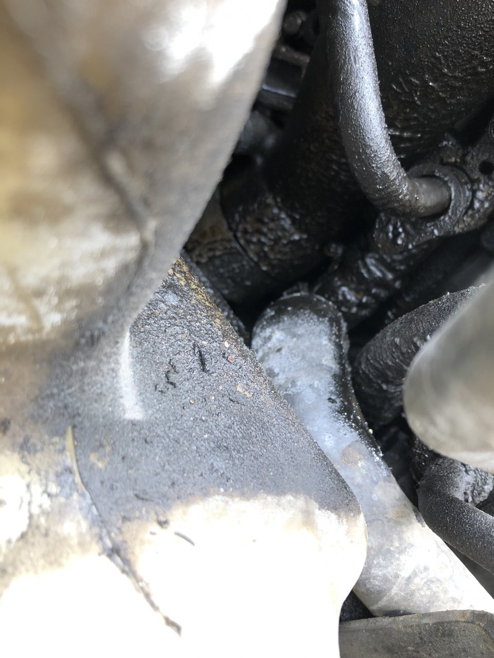

    There’s a lot of oil before the Turbo.. Where the CAC pipe goes to the Turbo.

    Just getting back from holidays. It sounds more like an air to air hose split or burst on you. Check all that. Your top picture is of the crankcase oil separator. It is just slobbering from somewhere there and making a bit of mess. This really won't cause loss of boost or power.
