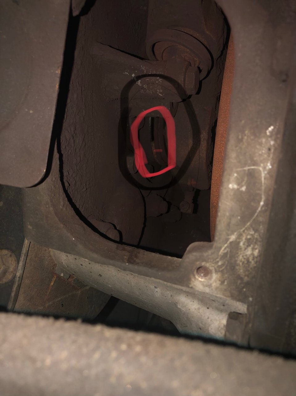

    They still can’t figure out where is the air pressure leak coming from. Also My clutch was grinding whenever I shift the first gear and the mechanic said that wasn’t Normal and I had the clutch replaced 4 months ago. He said that he can add a metal plate to adjust the gap in the clutch and the sound will go away and that I may need to install one every 3 to 4 months. The grinding went away after the plate was installed but now I’m hearing a grinding sound from the clutch while the engine is idling and it goes away when I press the clutch. When I start the engine I hear a loud grinding sound but when I press the clutch it goes away. Can you please let me know what could be causing this? Here’s the picture of where he installed it.
  8. Heavyd
    Heavyd Road Train Member
    7,804
    6,253
    Feb 4, 2009
    Clutch brake. They are a bandaid fix. If it is grinding, make sure it is adjusted properly. Did they install a new clutch brake when the clutch job was done?
    Sam718 Thanks this.

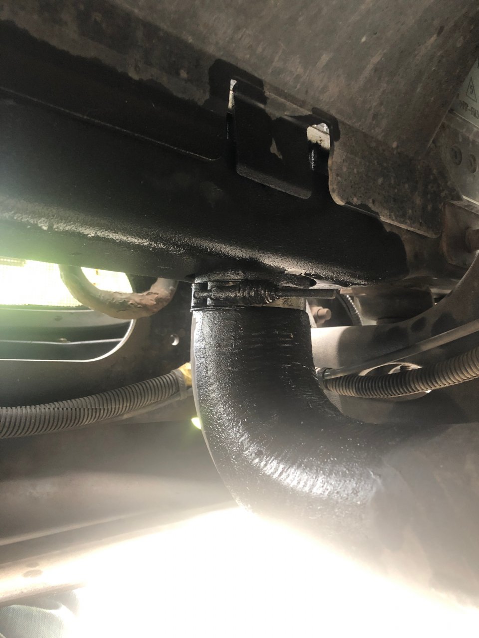

    Yes they did a new Clutch break as well.. I just had a Road service come to take a look at and he said that the transmission is shot because there’s no oil in their and tracked the oil leak from where the Radiator is. He said when the new CAC and Radiator was Installed they didn’t install the fitting properly and that’s what killed the Transmission.
    Attached the picture of it.
    Heavyd Thanks this.
