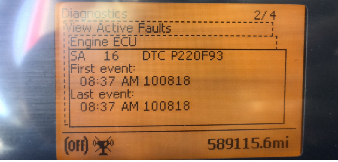

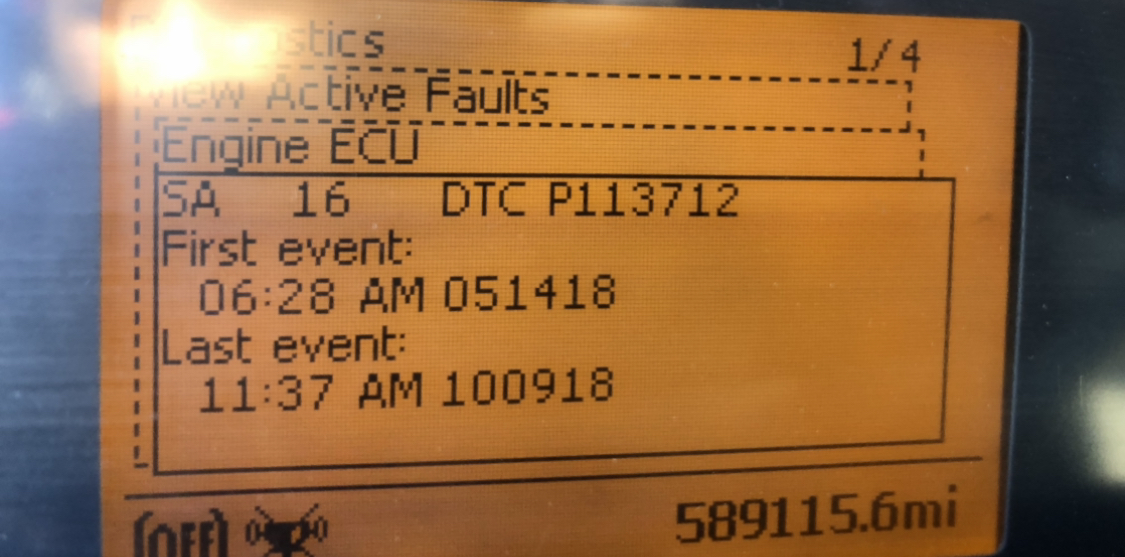

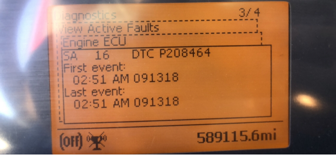

    Radiator temperature and hose are same I have some faults on diagnostic
