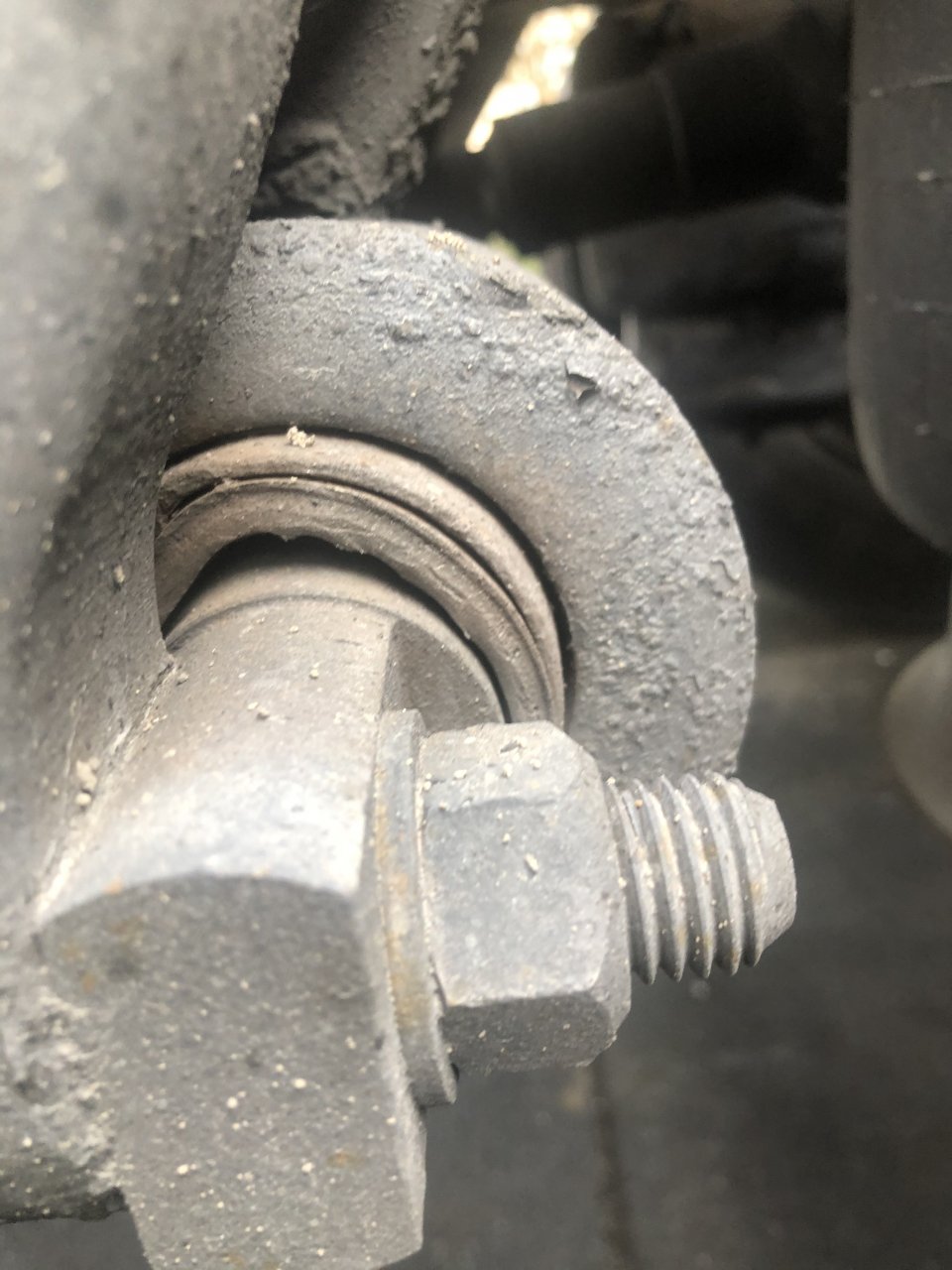

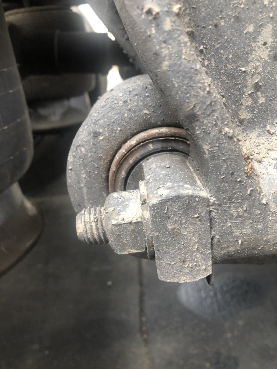

    177C512A-B60A-4A38-B4D5-C1135CA202D3.jpeg 40C55654-074E-477C-975C-8386EFB9B489.jpeg 9167CF38-0CFA-443B-A3FB-4F314B4A3FAA.png
    Used to be Road Squad. Now it’s called Pilot Truck care, looks like. Not sure if he’s still working there. Just looking at mine. They need doing again. It’s been less than 7 yrs. You can see the bad one in top pic. ( right side rear axle again) vs the left side. Might be because the spring hole was worn out of round. Left side still looks good. I think I need a new spring. If they weren’t the anti walk, might be loose and moving back and forth. I’m not very impressed with the Atro Poly bushings. The motor mounts didn’t last long. I’ve heard of them causing vibrations. Just the anti walk part seems like a good idea. I don’t think they actually last any longer than they regular original rubber ones.Anyways I-65 exit 86, the building next to Pilot. Closed today.
