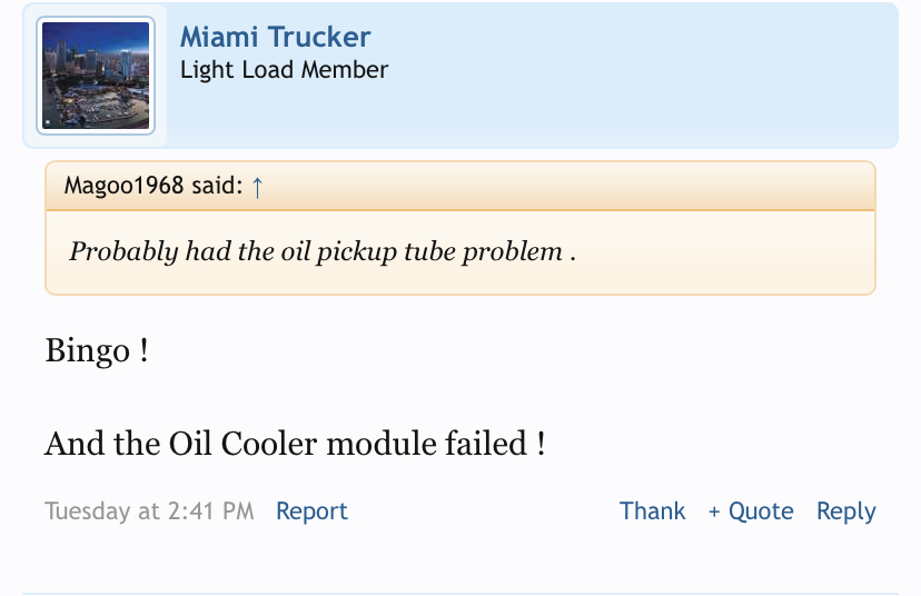

    Go back and read. Oil pickup tube failed, which resulted in a spun #7 main bearing. Probably will need a new crank and the journal ground for an oversize bearing if they are going to repair it. If not, new short or long block is another option.
