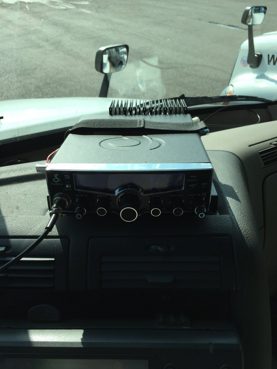

    image.jpeg No power problems with mine. Says it draws up to 30 amps had a volt meter to test it
