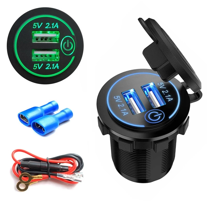

    If that’s the issue order a couple of these off of Amazon. EFEAE780-08E3-46A0-81FC-1456878FBAAF.jpeg

    Is there a trick to pulling out the old sockets? They are either glued in or maybe have a backing ring on the inside of the utility cabinet in the sleeper? Thanks again

    Mine screw together ...

    Mine just click into place, as for the retainer ring. Air gun works great.
