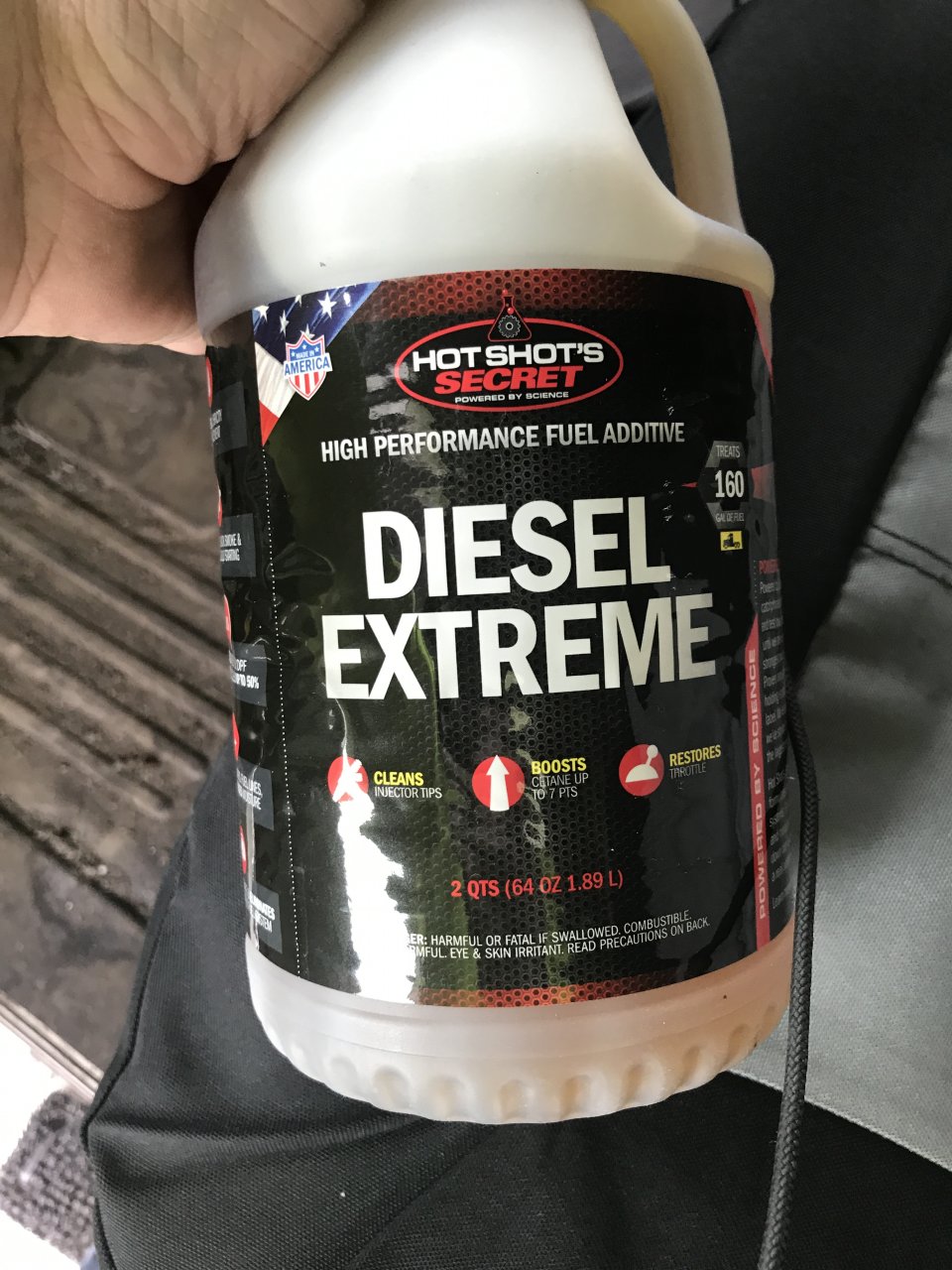

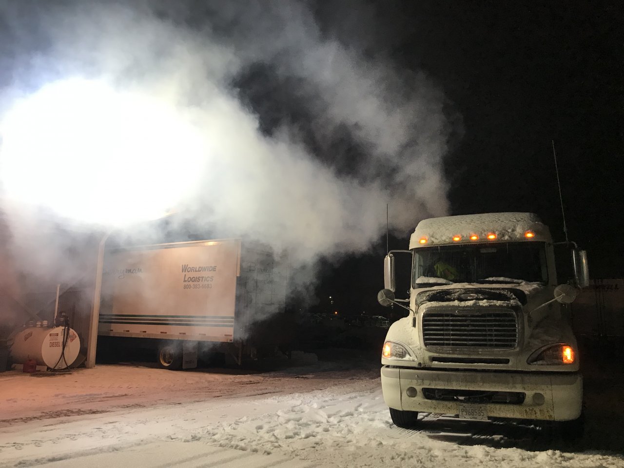

    I had a very similar issue. If it was cold outside, I could fill the parking lot with smoke and it would smoke all day. A good friend recommended an injector cleaner and after running 4 gals, truck hasn't smoked since. (It's been a week) The truck sat for 4 days over the weekend and I was sure it was going to smoke like crazy, but barely anything. Just food for thought, but you might want to try 2 bottles.

    Did you took a picture of my truck this morning?:) i will definitely try this but first i want to check oil and coolant. Thank you for your help

    LOL. That was my truck last weekend before I ran the cleaner through. It's not cheap, like $30/ bottle and I ran one in each tank. But I'm not losing coolant and I go through a gal oil every 20,000. But I also had a compressor leaking oil.
